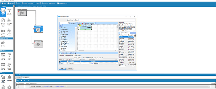

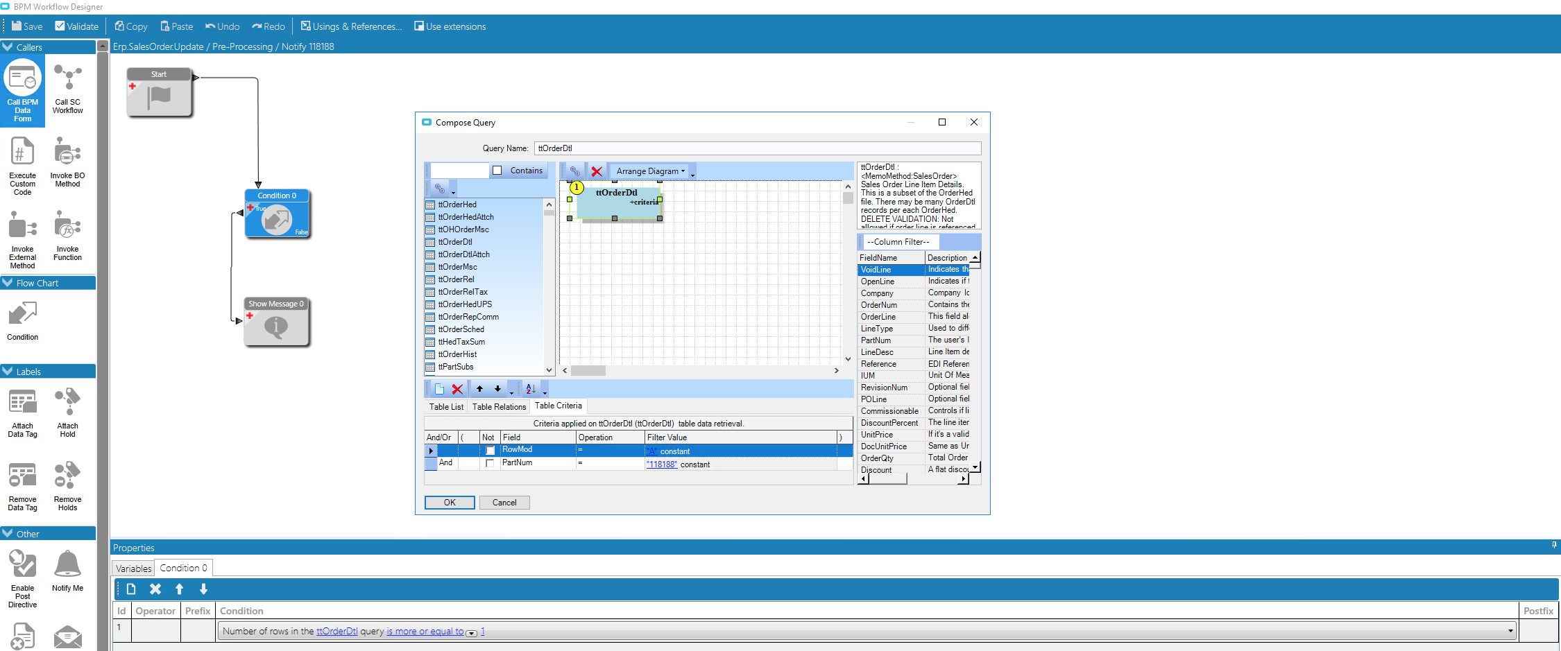

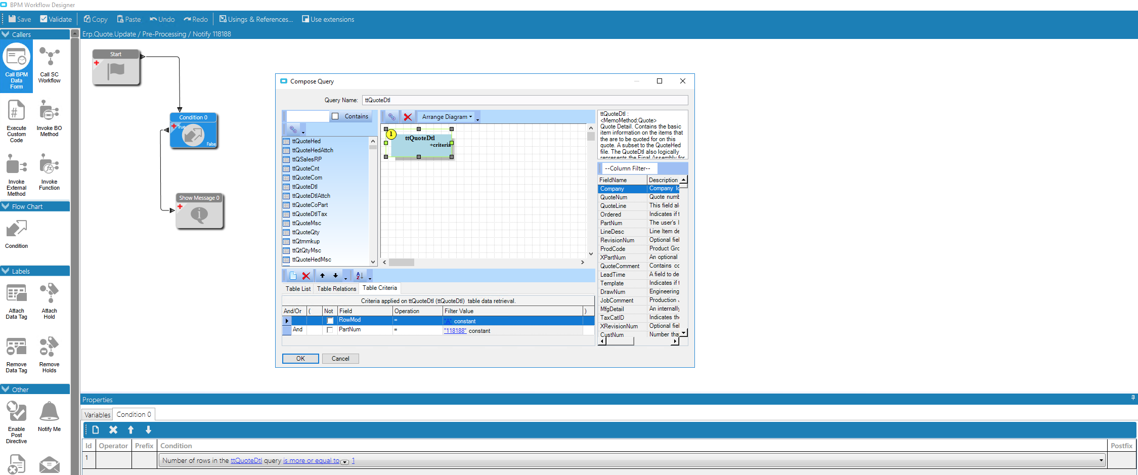

I have made many method directives and this one is super easy. A user enters part number 118188 and a popup says something that the manager wants it to say. They want this working on quote entry and sales order entry. I have it working on quote entry, but for some odd reason, it is not working in sales order entry. Does anyone have any idea what I could be doing wrong?
I have made a ton of these but this is the first time that it has not worked.
@epinoob If you don’t have the condition does the message come up? If not you may have to move to MasterUpdate rather than Update. Also if you are just looking for the added row to have the value you can have the conditions of there is at least one added row and the field is equal to ‘118188’ rather than a query linked to the tt dataset.
I don’t know what you mean by master update. Also, there are 79 other BPM’s that I have made using this method that work just fine. Like in the Quote Update one, it works as expected.

Also if the part number was changed to 118188 from something else your condition would not be met since it was not an added row, but an updated one.

It all depends on which method you attach to. In your OP, you attached to the Update method. This fires on save, but not on field change. You can try tracing your methods to see what is firing. Perhaps there is another method you can link to that is triggered when a user enters a value in the part number field and then exits. Probably a GetByID or something similar. Good luck!

Are you sure the row mod is A? It’s possible it’s saving it first, then it’s an update. (not likely, but still you could try it). Run a message and have it display the rows in the BPM.
