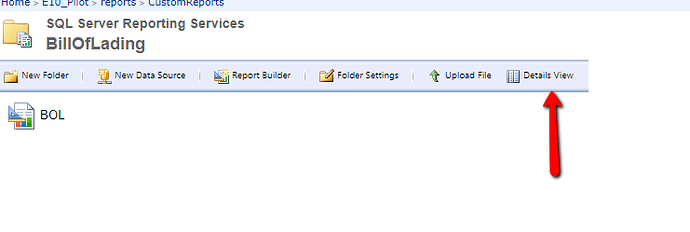

If you go to http://YourSSRSServer/Reports and then navigate to CustomReports and go to the Job Trav one change the view to “Detail View” and check the Date Modified.
It looks like the last date I modified, I’m beside myself. Mostly, it’s the traveler I converted from landscape to portrait. But I do think someone uploaded a portrait copy for me at one point. So, I may download and see if I can start there. Thanks for all your help.
