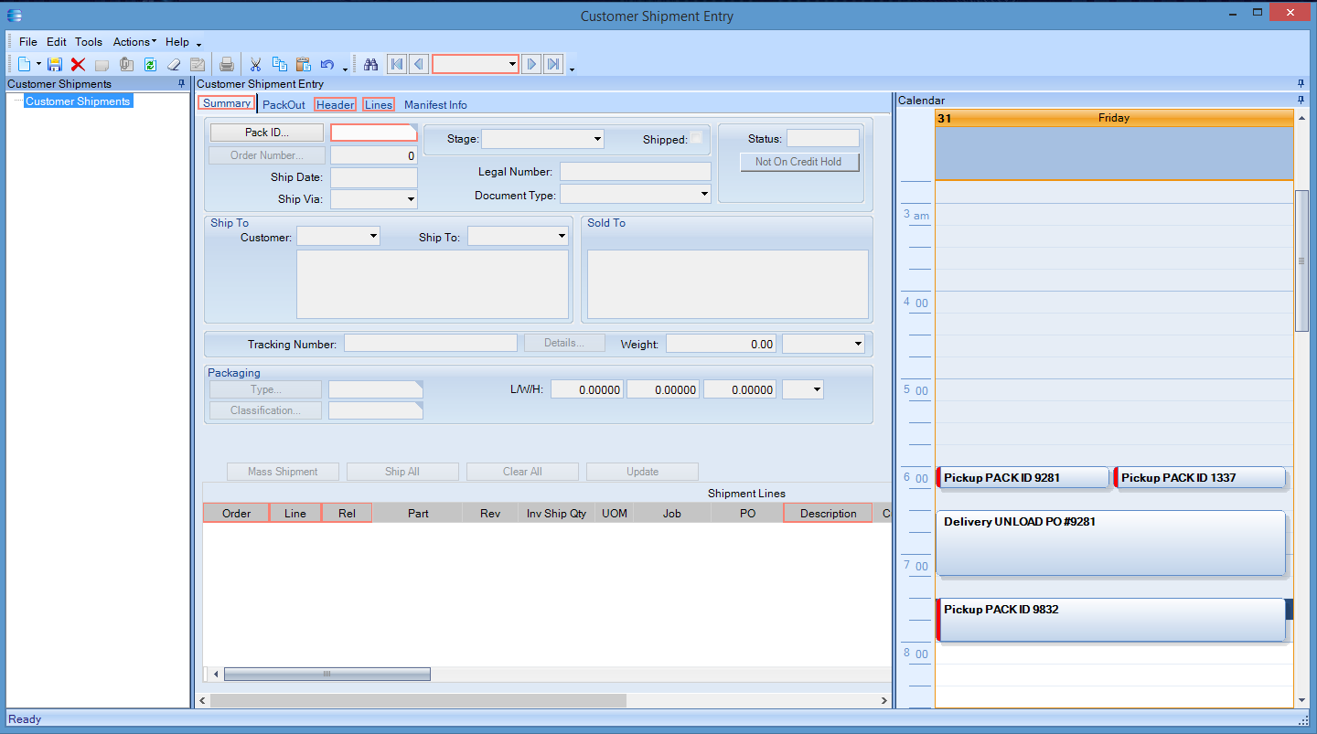

The one place I found EpiMonthViewSingle to be used on is Time and Expense Entry. Gist of it:
public Ice.Lib.Framework.EpiMonthViewSingle calMonthView;
this.calMonthView = new Ice.Lib.Framework.EpiMonthViewSingle();
this.mainDock1.calendarDock1.monthView1.calMonthView.CalendarInfo = trans.empCalendarInfo;
this.mainDock1.calendarDock1.monthView1.calMonthView.CalendarLook = trans.empCalendarLook;
// Infragistics.Win.UltraWinSchedule.Week is used as well etc.. for oTrans.empCalendarInfo.
To recap best option is googling Infragistics and looking possibly at Time and Expense Entry through dotPeek or Reflector.

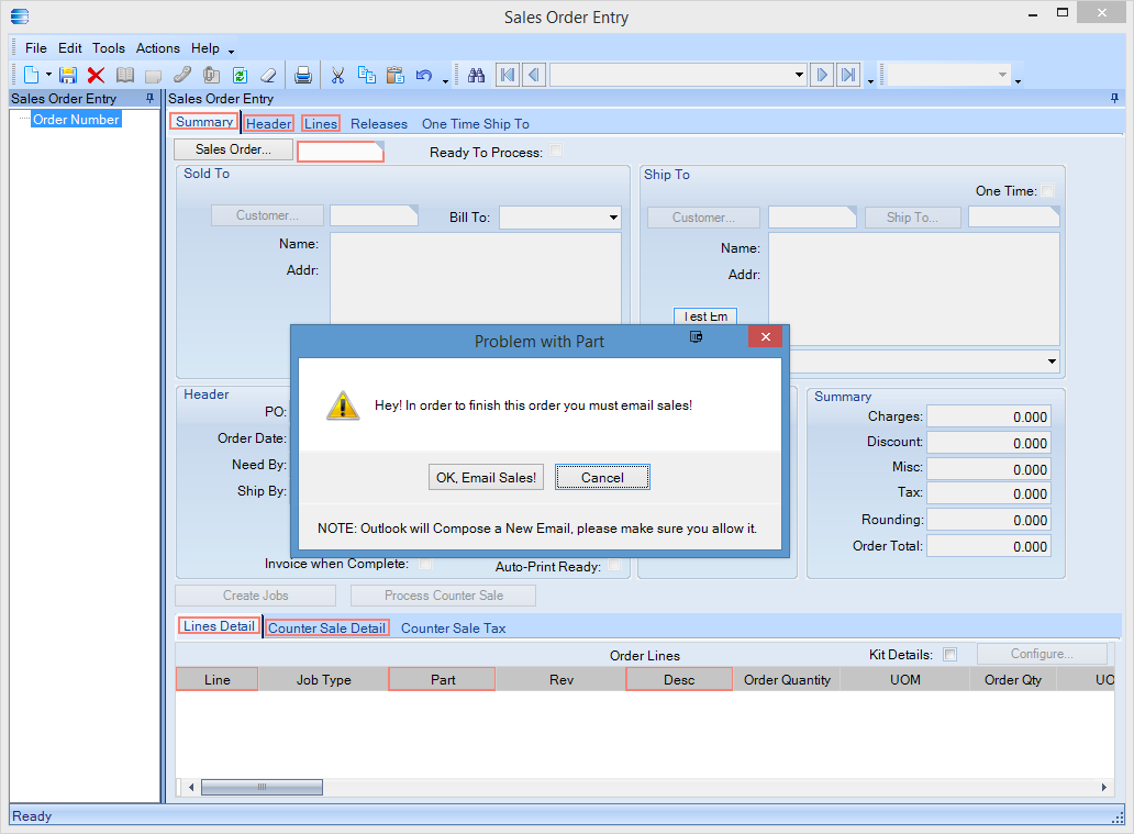

Gist from E9:
// Custom code for SalesOrderForm
// Created: 10/30/2014 8:50:46 PM
using System;
using System.ComponentModel;
using System.Data;
using System.Diagnostics;
using System.Windows.Forms;
using Epicor.Mfg.BO;
using Epicor.Mfg.UI;
using Epicor.Mfg.UI.Adapters;
using Epicor.Mfg.UI.Customization;
using Epicor.Mfg.UI.ExtendedProps;
using Epicor.Mfg.UI.FormFunctions;
using Epicor.Mfg.UI.FrameWork;
using Epicor.Mfg.UI.Searches;
//using Infragistics.Win;
//using Infragistics.Win.Misc;
//using Infragistics.Win.UltraMessageBox;
//using Infragistics.Win.UltraWinToolTip;
//using Infragistics.Shared;
//using Infragistics.Win.AppStyling.Runtime;
//using System.Drawing;
// Used for Managing Outlook Functions
using Outlook = Microsoft.Office.Interop.Outlook;
public class Script
public Infragistics.Win.UltraMessageBox.UltraMessageBoxManager ultraMessageBoxManager1;
this.testEmail.Click += new System.EventHandler(this.testEmail_Click);
this.testEmail.Click -= new System.EventHandler(this.testEmail_Click);
// Begin Custom Code Disposal
// End Custom Code Disposal
private void ShowContinueMessage(string message)
Infragistics.Shared.ResourceCustomizer rc = Infragistics.Win.Resources.Customizer;
// Customize the text for the Ok MessageBox Button.
rc.SetCustomizedString("MessageBoxButtonOK", "OK, Email Sales!");
rc.SetCustomizedString("MessageBoxButtonCancel", "Cancel");
this.ultraMessageBoxManager1 = new Infragistics.Win.UltraMessageBox.UltraMessageBoxManager();
using (Infragistics.Win.UltraMessageBox.UltraMessageBoxInfo ultraMessageBoxInfo = new Infragistics.Win.UltraMessageBox.UltraMessageBoxInfo())
// Set the general display style
ultraMessageBoxInfo.Style = Infragistics.Win.UltraMessageBox.MessageBoxStyle.Vista;
// Set the text for the Text, Caption, Header and Footer
ultraMessageBoxInfo.Text = message;
ultraMessageBoxInfo.Caption = "Problem with Part";
//ultraMessageBoxInfo.Header = "The Part you have entered does not exist or has no reference!";
ultraMessageBoxInfo.Footer = "NOTE: Outlook will Compose a New Email, please make sure you allow it.";
// Specify which buttons should be used and which is the default button
ultraMessageBoxInfo.Buttons = MessageBoxButtons.OKCancel;
ultraMessageBoxInfo.DefaultButton = MessageBoxDefaultButton.Button2;
ultraMessageBoxInfo.ShowHelpButton = Infragistics.Win.DefaultableBoolean.False;
// Display the OS Error Icon
ultraMessageBoxInfo.Icon = MessageBoxIcon.Warning;
// Disable the default sounds
ultraMessageBoxInfo.EnableSounds = Infragistics.Win.DefaultableBoolean.False;
// Set the Style so the dialog resembles the MessageBox as displayed on Vista
this.ultraMessageBoxManager1.Style = Infragistics.Win.UltraMessageBox.MessageBoxStyle.Vista;
// Change the alignment of the buttons
this.ultraMessageBoxManager1.ButtonAlignment = Infragistics.Win.HAlign.Center;
// Disable the playing of the default sounds
this.ultraMessageBoxManager1.EnableSounds = Infragistics.Win.DefaultableBoolean.False;
// Show the UltraMessageBox
DialogResult dialogResult = this.ultraMessageBoxManager1.ShowMessageBox(ultraMessageBoxInfo);
if (dialogResult == DialogResult.OK)
bool mailSuccess = SendMail();

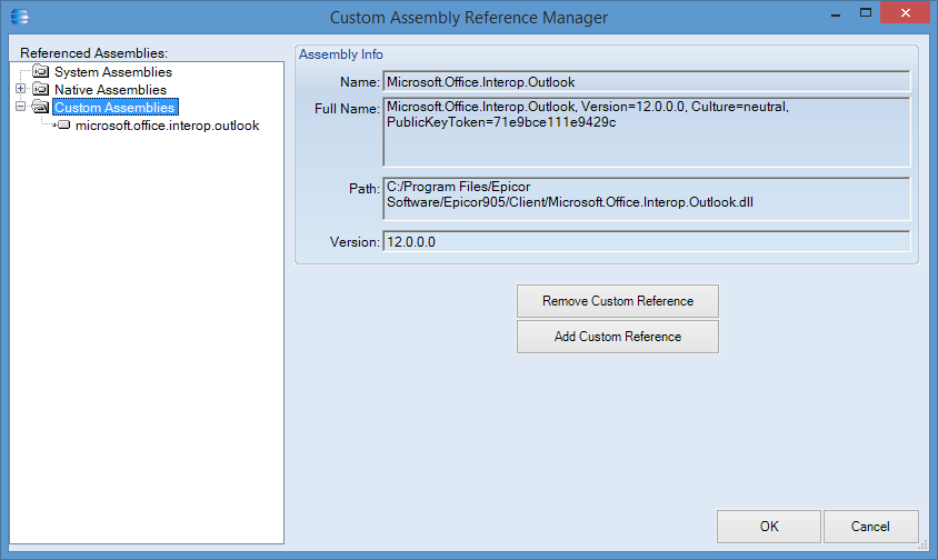

public bool SendMail()
// Initialize Needed Objects and Variables
Outlook.Application moApp = new Outlook.Application();;
Outlook.MailItem oEmail = (Outlook.MailItem) moApp.CreateItem(Outlook.OlItemType.olMailItem);
// Compose New Email
try
oEmail.Recipients.Add("hasok@wow.com");
oEmail.CC = "keric.haso@geemail.com";
oEmail.Recipients.ResolveAll();
oEmail.Subject = "Request: Part Missing or no Reference!";
oEmail.BodyFormat = Outlook.OlBodyFormat.olFormatHTML;
oEmail.Body = "Blah, blah, blah... Bla Bla Bla Blu Bla Haso Bla...";
oEmail.Importance = Outlook.OlImportance.olImportanceHigh;
oEmail.ReadReceiptRequested = false;
oEmail.Save();
oEmail.Display(true); /// Show the email message and allow for editing before sending
/// oEmail.Send(); /// You can automatically send the email without displaying it.
catch (Exception eX)
MessageBox.Show("Email was not sent! You have failed to allow Epicor to manage Outlook!", "Dienetics Error", MessageBoxButtons.OK, MessageBoxIcon.Error);
return false;
// Verify the Status of the Email
try
if (oEmail.Sent == false)
MessageBox.Show("Email was not sent! You have not clicked the Send Button.", "Dienetics Error", MessageBoxButtons.OK, MessageBoxIcon.Error);
return false;
catch (Exception ex)
MessageBox.Show("Email was sent successfully!", "Success", MessageBoxButtons.OK, MessageBoxIcon.Information);
return true;
return true;
private void testEmail_Click(object sender, System.EventArgs args)
ShowContinueMessage("Hey! In order to finish this order you must email sales!");

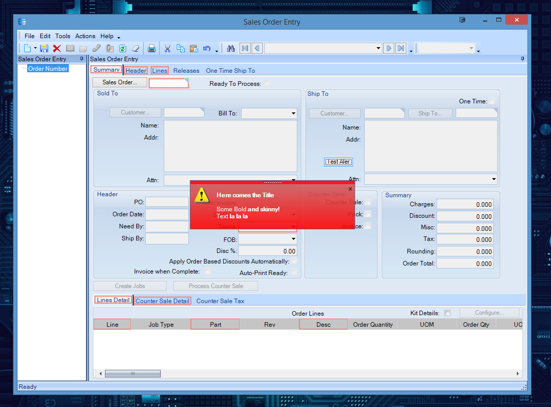

For the Red Alert / Notification:
// Reference: http://help.infragistics.com/Help/Doc/WinForms/2012.2/CLR4.0/HTML/Infragistics4.Win.Misc.v12.2~Infragistics.Win.Misc.UltraDesktopAlertShowWindowInfo~ScreenPosition.html
private void DesktopAlert()
Infragistics.Win.Misc.UltraDesktopAlert alert = new Infragistics.Win.Misc.UltraDesktopAlert();
alert.MultipleWindowDisplayStyle = Infragistics.Win.Misc.MultipleWindowDisplayStyle.None;
// Set the Opacity property to 90% opacity, to make the
// desktop alert window a little more noticable than it is with
// the default (80% opacity).
alert.Opacity = .9f;
// Use the link appearances to get a consistent foreground color across
// all links, and also so the font attributes are realized through the
// formatting and not the appearances.
Infragistics.Win.Appearance normalLinkAppearance = new Infragistics.Win.Appearance();
normalLinkAppearance.FontData.Bold = Infragistics.Win.DefaultableBoolean.False;
normalLinkAppearance.FontData.Italic = Infragistics.Win.DefaultableBoolean.False;
normalLinkAppearance.FontData.Underline = Infragistics.Win.DefaultableBoolean.False;
normalLinkAppearance.ForeColor = System.Drawing.Color.White;
alert.CaptionAppearance = normalLinkAppearance;
alert.TextAppearance = normalLinkAppearance;
alert.FooterTextAppearance = normalLinkAppearance;
alert.CaptionHotTrackAppearance = normalLinkAppearance;
alert.TextHotTrackAppearance = normalLinkAppearance;
alert.FooterTextHotTrackAppearance = normalLinkAppearance;
// Set the GripAreaAppearance or CaptionAreaAppearance depending
// on the resolved Style...the GripAreaAppearance applies to the
// Office2007 style, and the CaptionAreaAppearance applies to the
// WindowsLiveMessenger style.
if ( alert.StyleResolved == Infragistics.Win.Misc.DesktopAlertStyle.Office2007 )
Infragistics.Win.Appearance gripAreaAppearance = new Infragistics.Win.Appearance();
gripAreaAppearance.BackColor = System.Drawing.Color.Red;
gripAreaAppearance.BackColor2 = System.Drawing.Color.Red;
gripAreaAppearance.BackGradientStyle = Infragistics.Win.GradientStyle.VerticalBump;
alert.GripAreaAppearance = gripAreaAppearance;
else
Infragistics.Win.Appearance captionAreaAppearance = new Infragistics.Win.Appearance();
captionAreaAppearance.BackColor = System.Drawing.Color.AliceBlue;
alert.CaptionAreaAppearance = captionAreaAppearance;
alert.CaptionAreaImageSize = new System.Drawing.Size( 12, 12 );
alert.Appearance.BackColor2 = System.Drawing.Color.Red;
alert.Appearance.BackColor = System.Drawing.Color.IndianRed;
Infragistics.Win.Misc.UltraDesktopAlertShowWindowInfo showInfo = new Infragistics.Win.Misc.UltraDesktopAlertShowWindowInfo();
// Set the key to uniquely identify this desktop alert window
showInfo.Key = "myWindow";
// Set the Caption, Text, and FooterText properties using formatting
// characters that are recognized by the FormattedTextUIElement.
showInfo.Caption = "Here comes the Title";
showInfo.Text = "Some Bold and skinny!"; // you can use HTML Tags!
//showInfo.FooterText = "Click to visit the Infragistics website";
// Use the ScreenPosition property to make the desktop alert
// window appear at the top left corner of the screen
showInfo.ScreenPosition = Infragistics.Win.Misc.ScreenPosition.Center;
//showInfo.ScreenLocation = new System.Drawing.Point(200, 200);
// Use the Screen property to specify which screen the desktop alert
// appears in...in the case where the end user has amultiple monitor
// setup, this will make the alert appear on the last screen
showInfo.Screen = Screen.AllScreens[Screen.AllScreens.Length - 1];
// Show Alert
alert.Show(showInfo);
