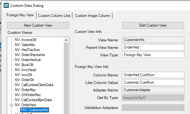

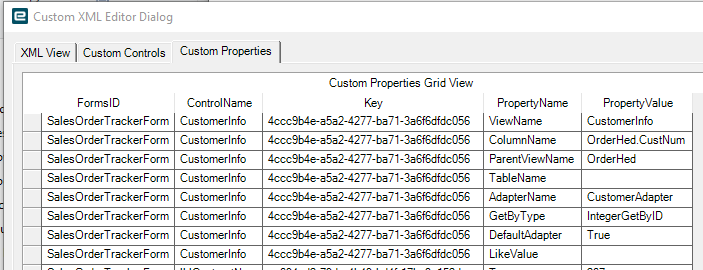

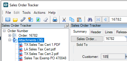

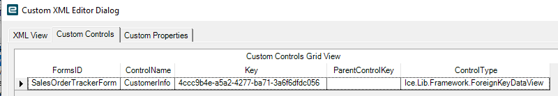

A while back someone put a customization in our system to display Customer attachments on the Sales Order screen.
How does this work??
This is all I see as far as the customization…
Nothing anywhere on attachments, or the tree…???
More stuff in case this helps yall help me…
// CustomerInfo
Ice.Lib.Customization.PersonalizeCustomizeManager personalizeCustomizeManager = this.csm.PersonalizeCustomizeManager;
personalizeCustomizeManager.CallAddForeignKeyView("OrderHed.CustNum", "CustomerInfo", "", "4ccc9b4e-a5a2-4277-ba71-3a6f6dfdc056", "CustomerAdapter", "IntegerGetByID", "OrderHed", true);
this.CustomerInfo_Row = ((Ice.Lib.Framework.EpiDataView)(this.csm.GetGlobalInstance("CustomerInfo_Row")));
System.Windows.Forms.Control topControl = personalizeCustomizeManager.TopControl;
topControl.FindForm().SuspendLayout();
But that is in the read-only area of the script editor. This code was also present, but if I comment it out, the customer attachments still show up.
