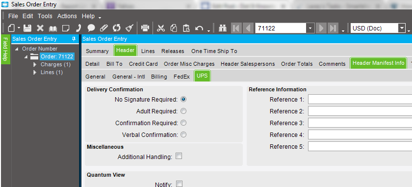

Do you happen to use Epicor Manifest? We use Manifest, and if it’s a UPS shipment (for example) on the Sales Order>Header Manifest Info>UPS, we have it configured as follows:
Reference 1 : If you leave blank, by default, the customer’s PO # will print on the shipping label.
Note: You can enter a custom value here, and whatever you type will print in Reference 1 on the shipping label
Reference 2 : If you leave blank, by default, our Sales Order # will print on the shipping label.

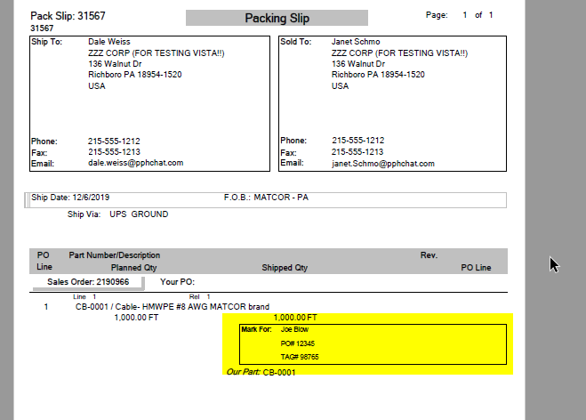

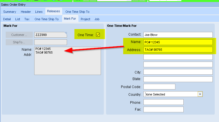

Have you looked at the “Marked For” on the Order Release?
Order Entry could add Mark For info on the order release. Just use the Address fields how ever you like.
Then it shows up on the Packer (and can be edited here too.
And appears on the label as
Also shows on the packing slip
Important thing to note is that the Ship To isn’t affected. So even though the “Mark For” looks like fields for an address, they can be used however you want.
Also, note that they’re probably limited in length (50?), and that the “city”, “state”, and “zip” will probably be merged onto one line
Wow ~ look at that! It does look like it will have an effect on Ship to, but doesn’t. I guess maybe this is what it’s for… Thanks Calvin!
