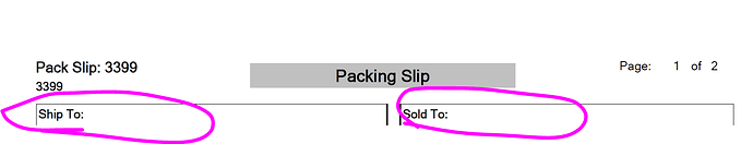

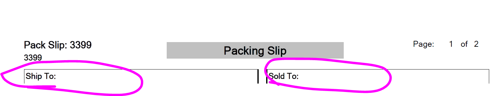

Hi @Mark_Wonsil
Thank you for your response.
Sorry it seems my attempt in trying to eliminate confidential data led to confusion (I did not want to show the actual Customer name and address in this public forum).
Here is my second try. I am hoping to figure out where the names are coming from (vs the address):
Here is why I am confused. You might have multiple orders of the same customer in the same packslip and for each order have a different attention to. I assumed that names are pointing to the attention to field but it seems I am wrong and have no idea how that is done.
