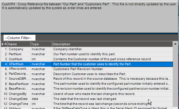

It’s a totally different table from the part master table. I don’t think it cares if the PartNum and the XPartNum field match or not. I’ve never used LabelVision myself. How does it get the information for the labels? Is it a SQL query, or a baq report or something? If it’s SQL I’m wondering if you can just get a left join so that it returns all of the PartMaster information, and if there isn’t CustXPrt table info, then it would just come back blank so you’re label wouldn’t fail. If it were me, I would investigate fixing that, because in the long run it will be less maintenance that copying over part numbers just to get the label to run.
Yeah, i need to check on that join. It isn’t SQL, but uses similar syntax.
