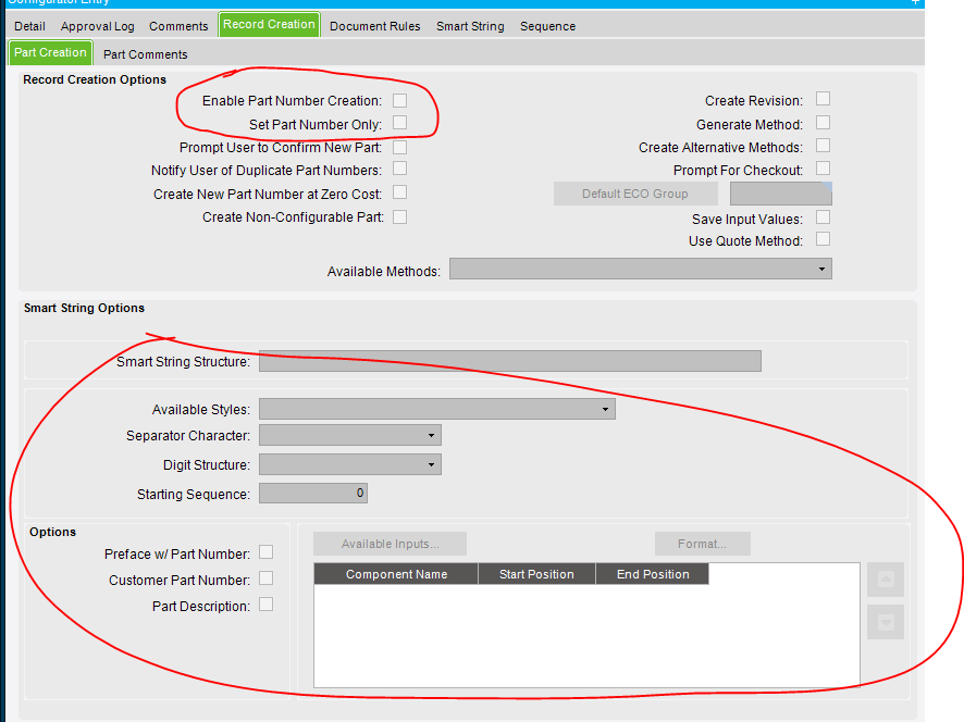

I am saying you should be able to change the base part using this in configurator entry. Not document rules
So for example: base part is called CFG-TRLEDG, real part is called IA1032. This real part could be anything based on the configuration as we have all of these part numbers in our system already and determining the correct one based on lookups. How would I make this work using record creation, part creation? Sorry if this makes anything more confusing, a little new to this myself
Got it to work the way we want it to!!! Thank you for your help

The way that the configurator works, you should NOT be changing the part number or the BASE part number with C# code in the document rules unless you really know what you are doing. When you manually changed the BASE part number, you basically disabled the configurator (unless the new BASE part number is also configurable). I have seen instances where we DID change the base PN intentionally, specifically if the results of the product was a non-configurable/stocked item.
