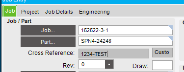

Can someone please tell me how to change a customer part number reference in Job Entry. The field is grayed out.
It’s most likely in Customer Part Cross Reference.
Go to Customer Part Cross Reference, Enter the Customer, then expand the tree view to see all parts that have a Customer Part Cross Reference.
Expand the tree view, click on the Part in question; I think you may have to delete the Part cross reference, then click New and enter your Part # and then enter the new Customer Part Number.
Thank you. I have changed the part number in the Customer Part Cross Reference, however, the job does not automatically update. I have tried to pull the details into the job again, but this did not work either. I am afraid the job may need to be unlinked, deleted and reentered. I was hoping for another option, especially if the job has transactions against it which would prevent the deletion of the job.
