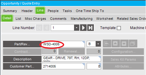

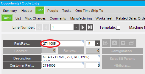

I guess to give a visual of what I’m trying to accomplish in the least amount of steps possible is this:
We won’t create an official part number until we get the PO from the customer. Once we receive that, our engineering department creates the official internal part number that we will use. Currently, once we get the PO and that is done, then we have to go into the original quote, and change the part number before we can put in the PO into an SO. We have to go into the quote, right click the OEM part number and open customer part number entry then delete the customer part and change it to the internal part number and then go back to the quote, enter the internal part number and then fill in the customer OEM part number which also then changes the date that the quote was done to the current date. I’m hoping we are just missing a step somewhere that can either be done by engineering when they create the internal part number or find a simpler solution for the CSRs when they enter the PO as a sales order. But we also need to make sure that the quote has the correct internal part number as well.
