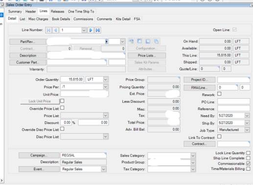

I’m not sure. We do this type of order all the time and I’ve not seen that. I tried several things in our sandbox, but I can’t repeat the behavior you are describing. Maybe a snapshot of the line/release tabs might help?
Given above the line and release tabs

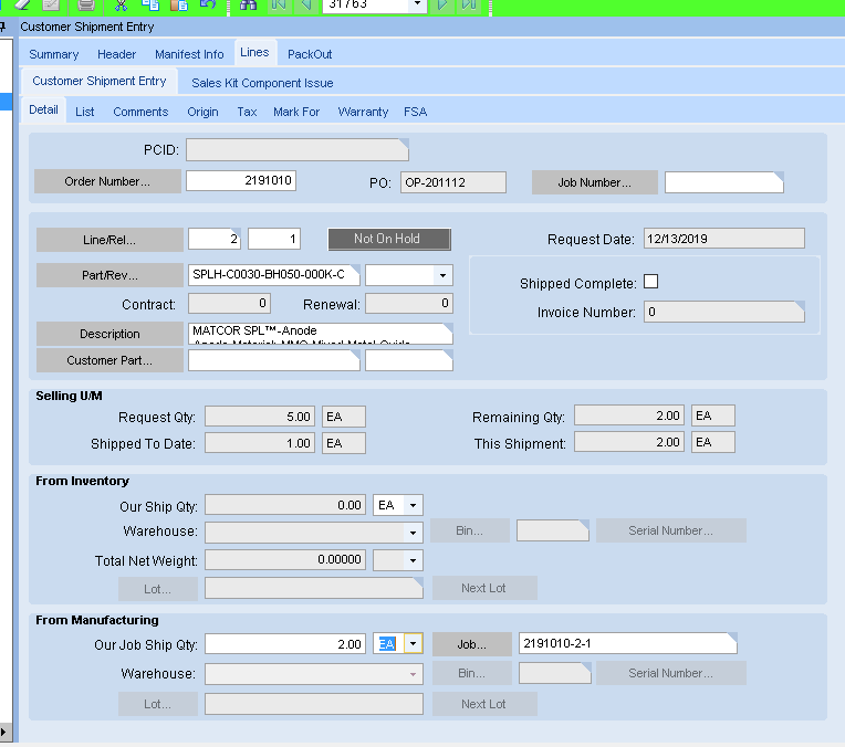

So your Customer Shipment Entry window looks like the following, until you hit save?
After hitting save just the “Our Job Ship Qty” and “Job num” fields go blank?
Have you run a trace to see what happens upon saving? Maybe there’s a BPM to prevent doing a Ship From, because you never wanted to do it before.
I found the issue. There was an old data directive that was causing the problem. While I had disabled the method directives and forgot about the data directive.
