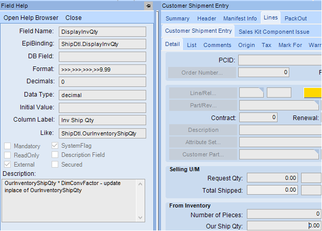

We had a request to stop the defaulting of the Our Ship Qty field in the Customer Shipment Entry > Lines form. It’s due to their data and how it was converted from another system.
So I tried a BPM on Erp.BO.CustShip.GetOrderRelInfo (due to notificing the field defaults right after I enter a release number) to force the field to 0 using all 3 types (Pre, Base, Post). Pre and Post didn’t change the value, Base seems to just kill the rest of the form processing from happening (things like Warehouse, UOM, etc. don’t load).
I looked at the Field Help and it is a calculated field, so I tried both setting the DisplayInvQty to 0, then I tried OurInventoryShipQty, both to no avail. I then attempted to use a form customization, EpiViewNotification > Initialize, but that didn’t work most likely due to order of processing.

I tried a few things and I think the background calculation of the shipped and remaining is never going to allow you to clear that value. What I would try is to add an unbound field and on leave from that field set OurShippedQty from it and set RowMod of that dataview to U call Notify to tell the app the change happened.
Once you have that running you can put your field over theirs or stick their field at the bottom of the section.
