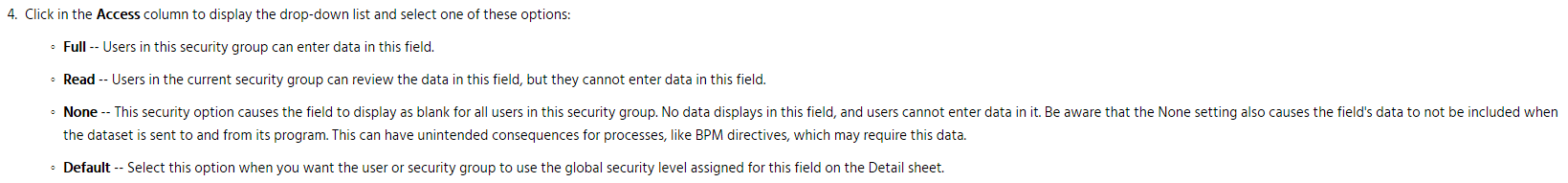

Field Security Allows
Full Access
Read Only
No Access (None)
What other flexibility is it lacking for you? It can do it by table by field by group and down to an individual user.
