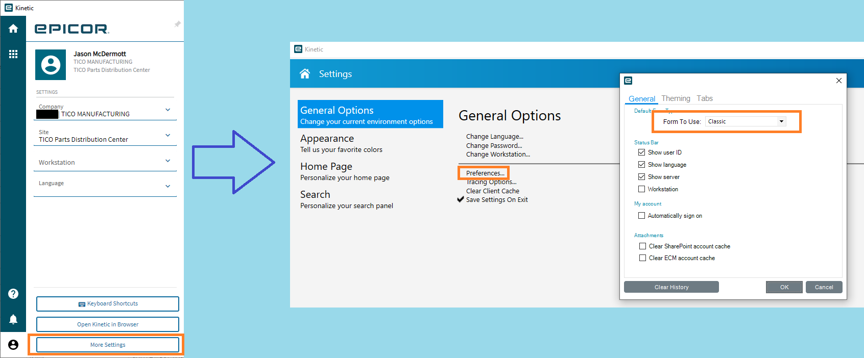

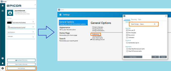

I know of two ways to force classic screens to open:
  1. Set it for everything
  1. Or do it screen by screen (hold the Alt key when opening and you get the “Form to Use” option like above but it affects just that screen).

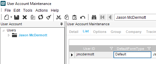

I already forgot, but I think option 1 is stored here:

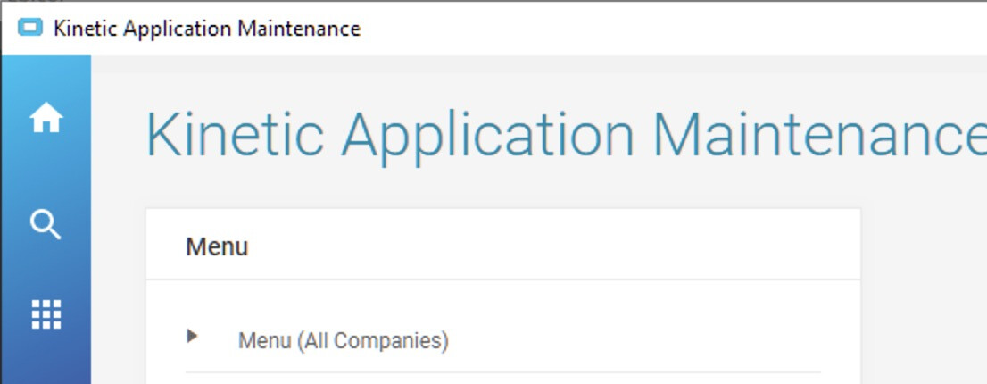

Maybe in Kinetic Application Maintenance? I’m on 10.2.700, but maybe something similar is in later versions?
Thanks, but I believe in 2022.2 the Kinetic Application Maintenance screen no longer exists.
Huh, somehow I missed the 30 (!) posts on this - I did not know this screen existed - but apparently they moved it in your version.

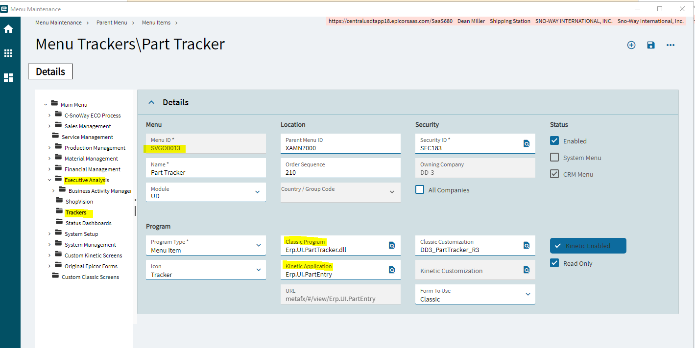

To force Classic in 2022, there are three fields in the Menu table that need specific settings:
OptionType = “I”
DefaultFormType = “Default”
Arguments = remove the “-KineticUI” flag leaving all others
To use the DMT, if you’re on SaaS, you also have to add your Company ID in the Company column.
You have to go into menu maintenance change the form type to kinetic on every individual menu item. But that won’t allow you to apply a kinetic customization. To apply a kinetic customization you have to copy the menu item to the current company, change the type to kinetic app, and then select the customization.

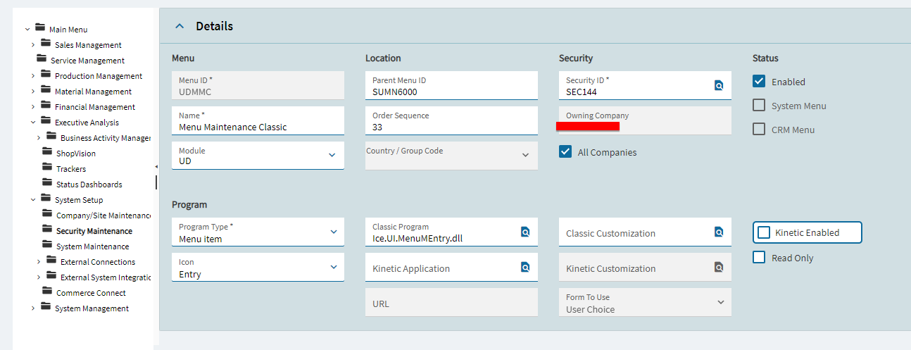

Have you ever been successful in creating a new menu item using the classic .dlls? We are a new SaaS customer, with Kinetic only. We have tried to create a new menu item for a classic form by setting the Program Type to Menu Item, which presents the Classic program box. However, whenever I search for a classic program, I get the “Sorry! Something when wrong…” message. I had a consultant send me a few classic forms to type in, and I get the same error when I try to save it.
I have not, but I am sure some of the other users here have. When we created a new classic form and attached it to a menu we used a consultant.

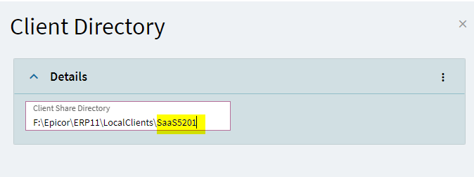

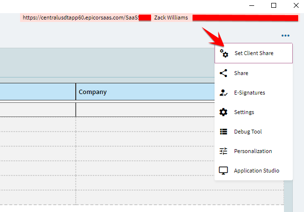

While in Menu Maintenance go to your Top Right Actions menu “Set Client Share”
The default location is wrong. Replace the last part with your environment name; ex. SaaS5201Pilot
f:\Epicor\ERP\11\LocalClients\<YOUR_ENVIRONMENT>
This should allow you to search for and enter the classic .dll program names. *I always make the classic Menu Maintenance screen first
Thank you…that basically solved my issue. I still have strange things happen with the Classic program search…When I filtered the search results to programs containing ReportEntry and selected the 1 that was displayed, I got a totally different program returned to my menu item (Ice.UI.AccessScopeEntry.dll). However, by copying the exact program name from the search results and pasting it into the Classic Program field, I was able to successfully reach the classic version of the form.
Thanks again for the insight…I’ve been trying to add some classic forms during a new implementation of Kinetic without luck, until you helped out!
