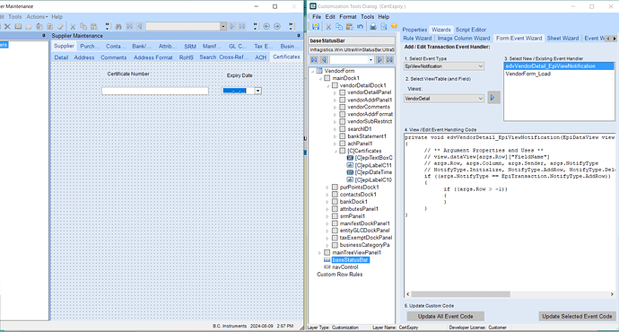

Customization Assistance: tying a UD table to supplier detail

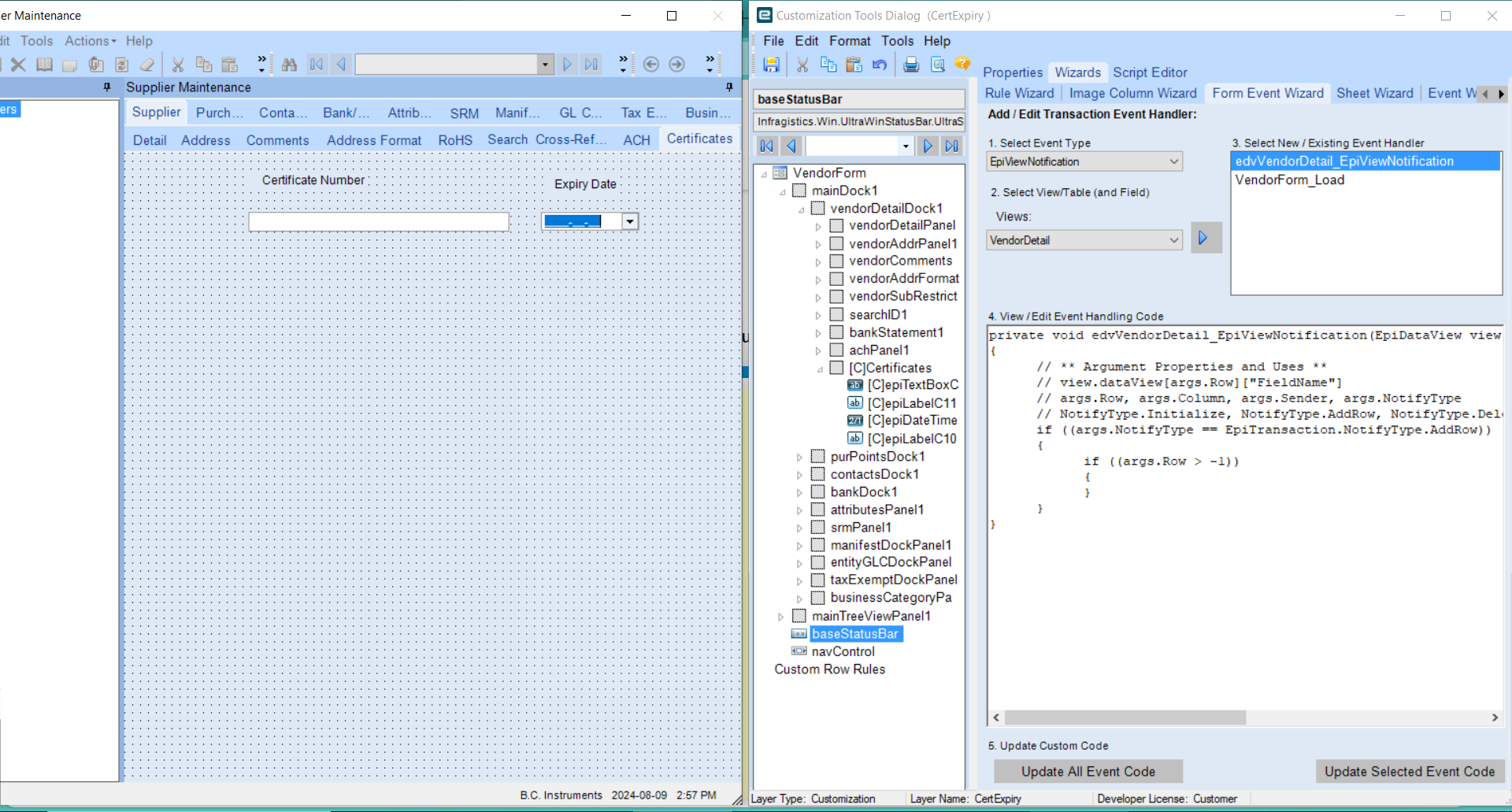

Some assistance would be greatly appreciated here as I am attempting to add a customization to a classic screen. I have added a tab to Supplier for Certifications and then added a text and date picker. Added a Form Event wizard, thinking that this will be dedicated to a supplier. Saved the Customization layer and applied it to Menu Maint.
The problem is that the text label and date picker are not specific to the Supplier ID, rather just on the form. (entering Test123 as the Cert and end of month for the date, it applies to every supplier instead of the vender specific to a venter ID.)
How do I tie the customization to the Vender ID.

Did you make fields on the Vendor table for these and regenerate the schema, recycle app pool? Then after that the fields will be available in Epicor to bind the to your inputs.
no, how do you do that?
I figured it out, Thank you
