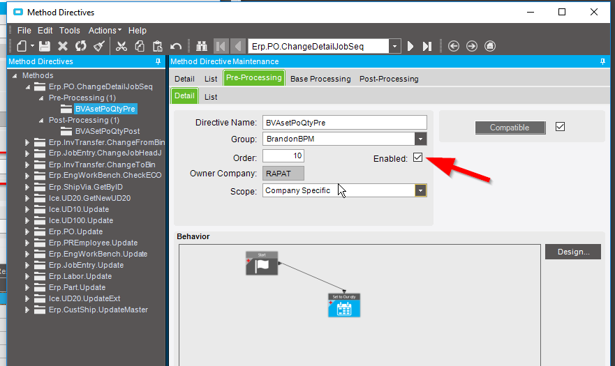

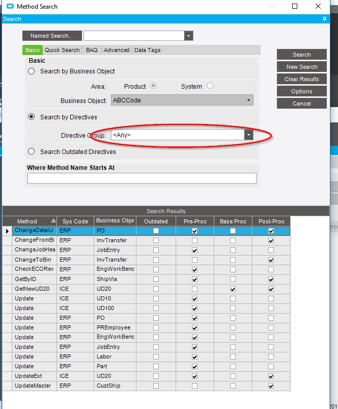

For BPM’s if you do your search and search by directive any, you can open up all of your BPM’s at once, so going through the list isn’t that bad. Just uncheck enabled.
