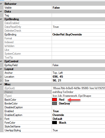

I am having issues setting the back color and border color using an epiShape. I am trying to mirror the Buy To Order ‘Override’ box to display red but it keeps defaulting to the original green color. I set it to red as the back color but it’s not sticking. Anyone able to successfully change the shape’s color or where is this set? (needed to re-create because the tools doesn’t allow a cut and paste option to a new group box)
Take a look at these posts:
https://www.epiusers.help/search?q=epishape%20StatusTypes
