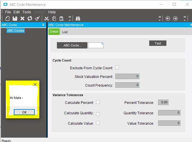

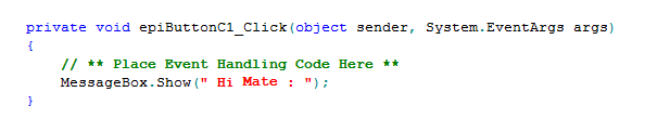

Hi Elias,
please forgive my ignorance, may i jus ask why not using the standard Button_Click event ?
Pleas forgive my ignorance.
I didn’t realize customizations had using System.Windows.Forms; nor that I could add references to the Script class. This is exactly what I was looking for.
