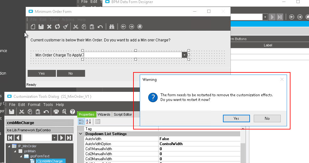

This is more a commentary than a question. But as of 10.2 when you go to make a customization and you exit without saving changes you get the following prompt.
So if NO changes are saved you are asked to automatically restart the form… however if you make a billion changes and turn the form inside out… Epicor just ignores all that and you have to manually restart the customization to see the changes. I am not 100% sure why someone went out of their way to make this functionality but its backwards as heck!.. Not to sound ungrateful, but now it sits there mocking me every time… when I don’t actually need to restart the form.

So that call actually came in and was deemed severe enough (not sure by who) that we should address it.
When controls are added or moved on the form, customization will track the changes for saving but it doesn’t know the original “State” so if Customization is exited and not saved, visually the form looks like it has been customized but all the information about the customization has been lost.
Now - what we did with the annoying dialog doesn’t actually fix the reported issue (I suggested user training but that got me sent to my room) as you can say “no” to the restart and still go back into Customization. Several options were discussed including keeping the Customization in memory and restoring on re-enter of Customization (that would also have kept non-visual code changes), and disabling the Customization option if a user exited without saving (I am sure most of you would have been really annoyed with that) so we apparently opted for the annoying dialog.
I will make a request that we make the ShowDialog logic a little more intelligent and we should only pop the message if visual changes were made to the form.
