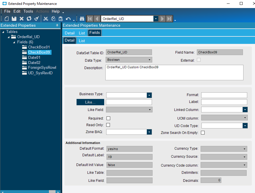

Been awhile since I was on E9, but I swear it had the Extended Properties maintenance. Where you can set the read only flag.

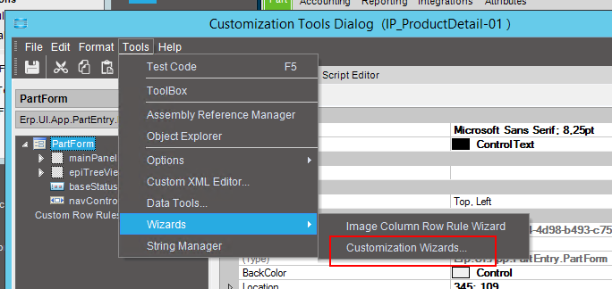

In the customization go to Tools -> Wizards -> Customization Wizards
Select Modify Extended Properties
Pick your View , your Field , your ReadOnly extended Property and set it to True

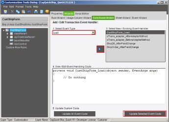

If you are still having issues, you can explicitly assign the property to the control on the form load, but depending on the form you may need to put this multiple places. For example, create an on form load method using the form event wizard:
Then, add something like txtControl.IsEpiReadOnly = true; of course, you’ll want to put in the name of your form controls.
Jose,
I have a questions about the Extended Property Wizard -
I want to make a checkbox read only -
In the Value - I sent it to True
Do I also need to add a value if it is False?
