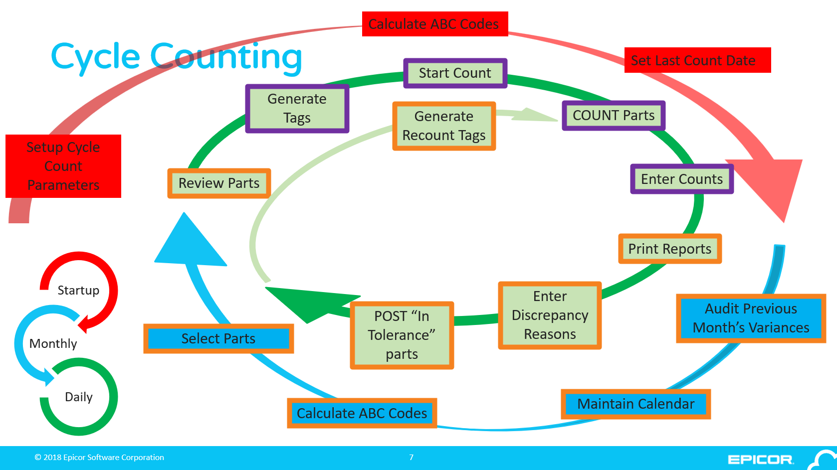

yes, your problem is that the when the system selects for the period, it can only select every part one time. a part cannot be active in any cycle count more than one time. SOOO… if you want to count A items 4 times per year, then you need to have AT A MINIMUM, 4 different count schedules.
I typically recommend that you do 12 schedules, even if only counting a items 4 times per year. This allows for changes during the year… so…
  1. every month, seelct the new parts for the new month
  2. every day, do your counts, and post the counts
Here is an illustration that shows the SETUP (red) vs MONTHLY (blue) vs DAILY (Green)
Thats a pretty dope graphic you’ve got there! Explains a lot better than the manual, that’s for sure.
We do a weekly count, and average about 40ish items across the entire company, so I may stick to the quarterly, but good to know my guess will work. (Literally setting it up to try in Pilot).
Appreciate the help!!
thanks for the compliment on the graphic. I assembled that using Powerpoint graphics… note that the BOXES around the text are also color coded… the orange borders would typically be done by administrator/supervisor. The PURPLE borders are items that would be done by stock room person.
