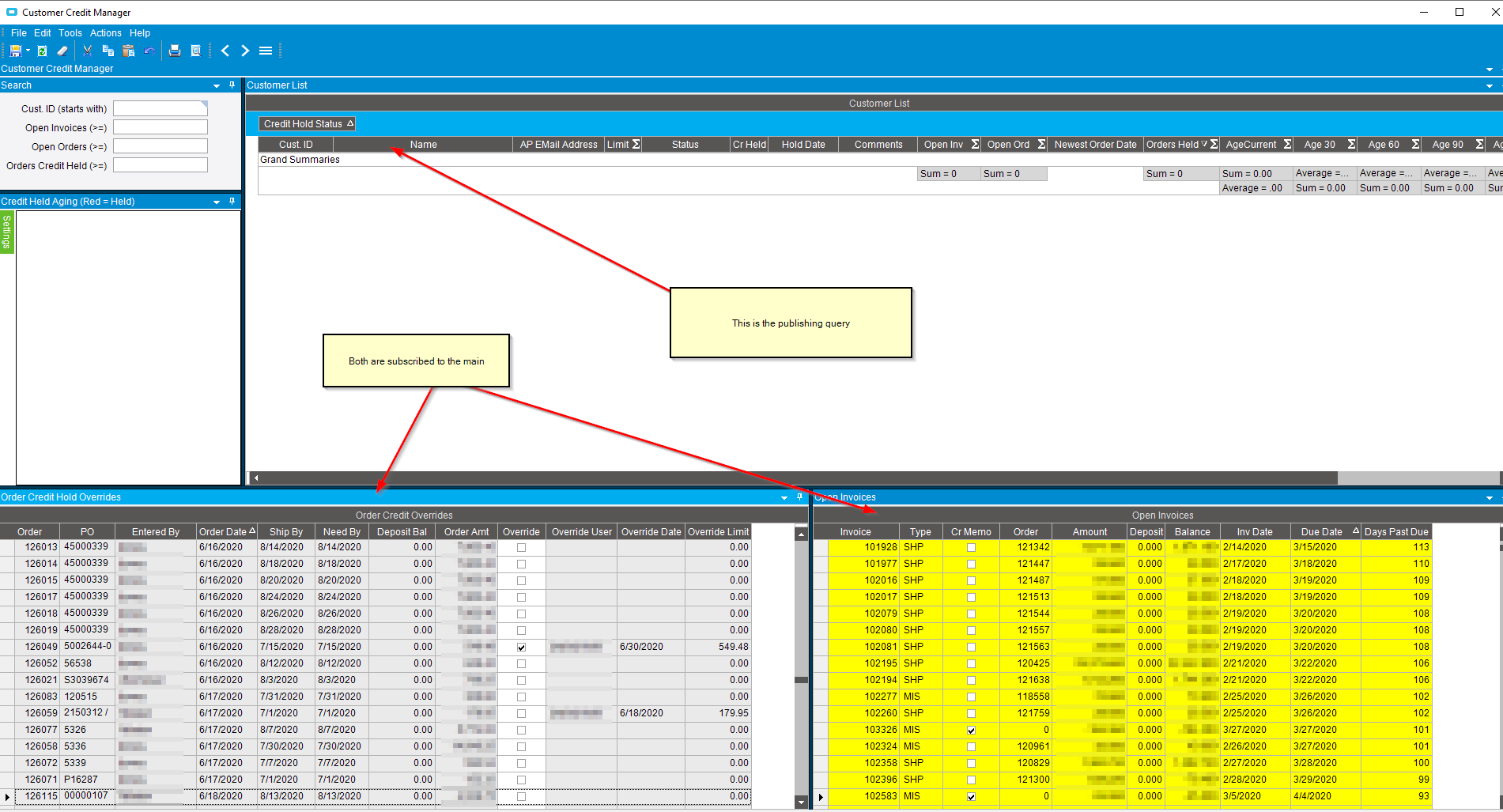

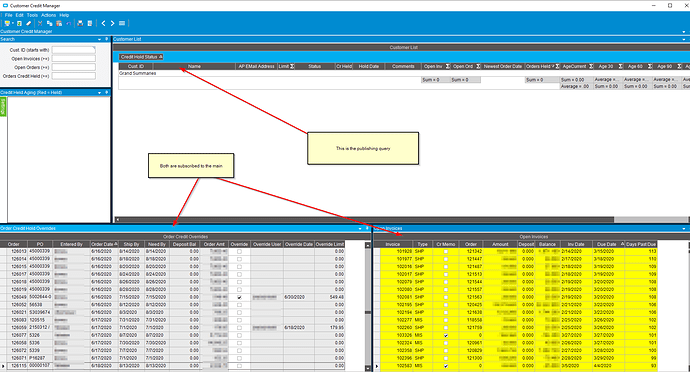

No auto load. It’s very strange no doubt. But I think I see what is happening. This happens more often dashboards where there are subscriptions. I just tried it again on a really basic one, and found that when I left customization mode that the dashboard loaded the subscribed query but the main one is still of course empty. I suspect what is happening is that the dashboards that really lock up have a lot of data in the subscribed queries and eventually just time out. But if I first refresh before going into the customization editor, the main query has data so when I exit it refreshes just fine.
This is an example of after leaving the customization editor where it loaded the subscribed unfiltered
