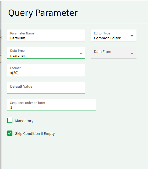

Is Skip Condition if Empty checked on your BAQ param?

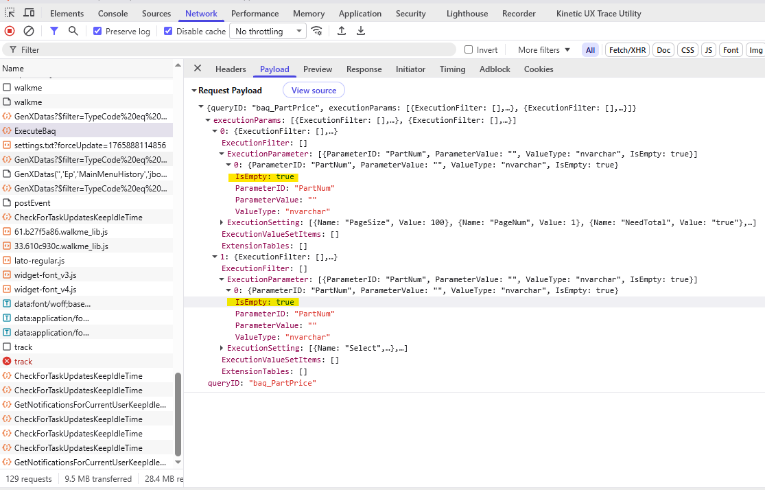

If so, are you seeing isEmpty: true in the ExecuteBaq request?
Yes it is marked Skip if Empty and yes in the payload it does say IsEmpty: true for both rows. (why are there two rows?)
Those settings are working for me (2025.2.7) on a vanila wizard dashboard with those param settings. It could be a version thing or perhaps you;re doing more than vanila in View Options or Provider Model. For examle, I’d not be suprised if BAQ Where Options has this affect.
Epicor sends both before and after row images for legacy reasons. :face_vomiting:

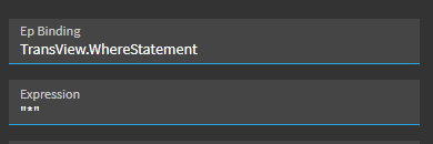

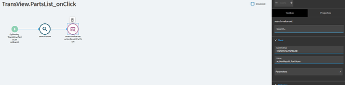

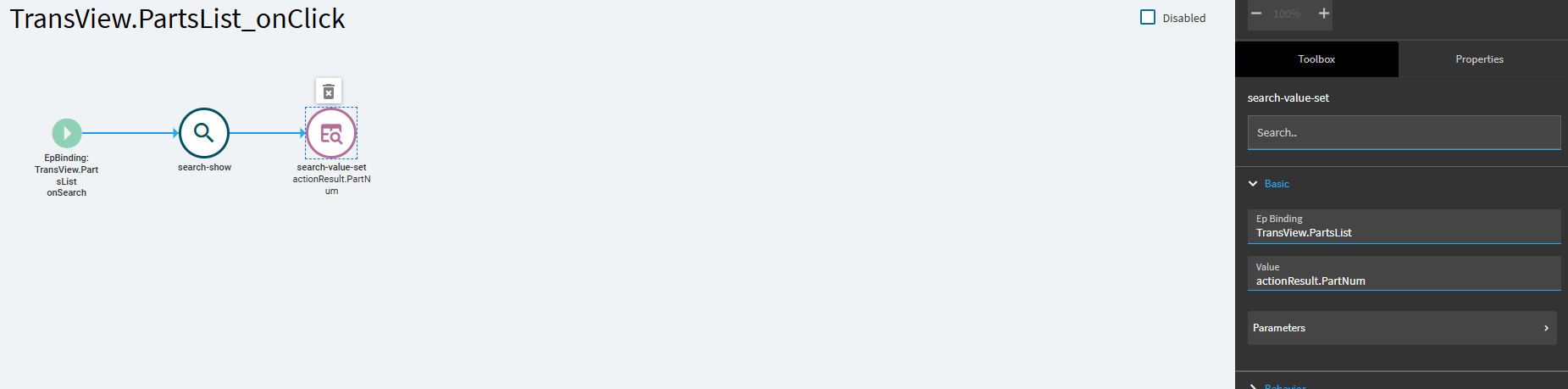

So my goal was to load all parts unless I feed it a list of parts to filter to. Maybe I’m so far into this I’m missing an obvious thing. But I found that I can control the statement that gets inserted into the Where clause in the BAQ Options inside Provider model. I also found that if I give it something that doesn’t “evaluate” it just returns everything. That’s great. I set it to a nonsensical character like * on initial load of the grid and it shows me all rows.

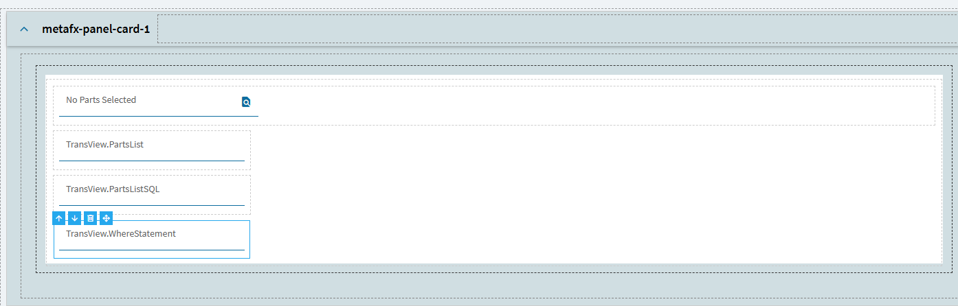

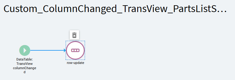

If I then select parts using the selector chip search, I am getting the stupidly formatted ~ delimited list of part numbers. I then setup an event on column changed of the TransView.PartsList (which is what the search is bound to) and set TransView.PartsListSQL using the function to convert the delimited list. This works mostly fine (it’s adding an extra space in front of part numbers but it doesn’t seem to stop it from working). This is where I am not quite able to make the leap, though.

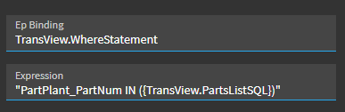

I have a third TransView field called WhereStatement. My Where clause I mentioned earlier is set in this column. When the PartsListSQL column changes, I have another event fire that changes the WhereStatement to:
"PartPlant_PartNum IN (?{TransView.PartsListSQL})"

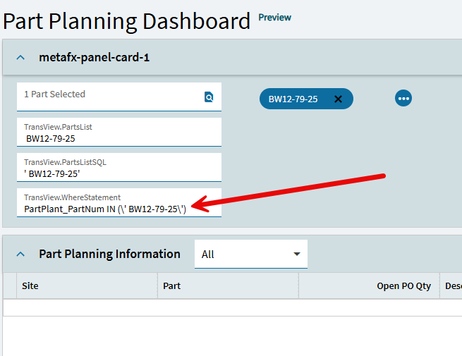

This works except for one problem. It’s bringing in the “escaped” value of PartsListSQL and that breaks the Where clause and it won’t properly filter. If I remove the slashes, it works fine. But it wants those slashes in there. Here’s some screenshots. Any advice is appreciated.

So this is evaluating the {TransView.PartsListSQL} upon row-update instead of putting that literal expression in the BAQ Where and letting the BAQ evalute upon execute.
I think that’s why you’re getting escape chars and also possibly why the question mark isn’t preventing the filter when empty (the BAQ Where eval never sees a question mark).
I’d try hard to avoid that double row-update unless you have a good reason why you want TransView.WhereStatement for other filtering purposes. In that case, you could handle the escape chars, but you may open this up to other handling of unforeseens later on.

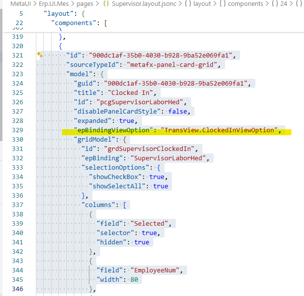

There supposedly a prop on panel-card-grid called epBindingViewOption but I’ve not found how to set it.
MES Supervisor page has an out of box example of binding ViewOption on a grid to TransView so it should be possible:
