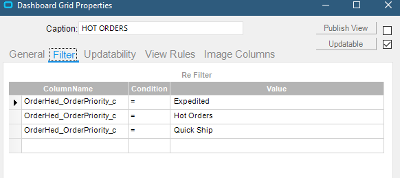

I have a dashboard with 2 grid views, each using the same BAQ. I’d like to filter one of the Views to include only specific entries in a custom field that is driven by User Codes. There are 6 possible string values in the field (blank is also possible), and I want the view to show only rows that contain one of 3 of those values.
When I set it up to include my desired entries, nothing shows in the Grid, which I assume is because it is looking for ALL of those to be true (AND instead of OR):

Essentially, the best method is to create a calculated yes/no field in the BAQ that includes the multiple values you want to include in the grid view. Then in the dashboard, filter by the new calculated field.
I knew it was simple!
Had you not had access to the BAQ to add the calculated field, I think changing that last filter condition to
OrderHed_OrderPriority_c > " "
Would have worked.
