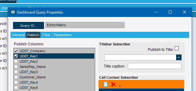

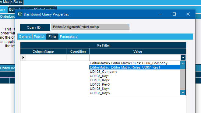

You would use publish and subscribe. In your parent BAQ properties, there are checkboxes to publish values. Then in your child BAQ’s you would use the dashboard filters to filter by those published values.
This creates the tabs as well?
No, this just makes it so that the first query selects the data for what you want to see on your other tabs.
Your parent query has something like a list of job numbers.
The child queries can filter by the job number that is selected on the parent query.

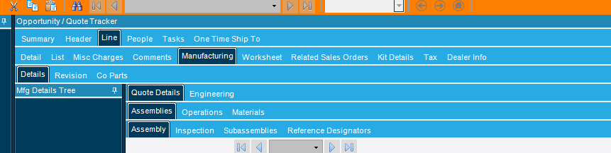

I’m assuming that you are looking for tabs like this? Where there are tabs under other tabs?
You can’t do that in a dashboard without customization. You can either just publish a dashboard with just the parent BAQ then customize to add the other embedded dashbaord, or use a UD screen to make it.
