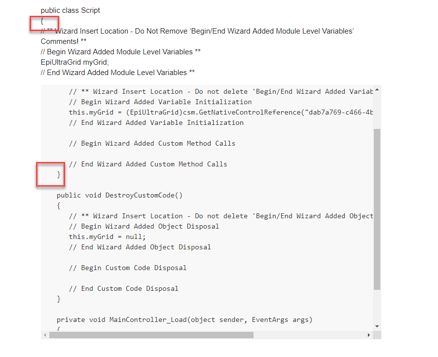

yeah the second one was what I just added when I was looking for missing closing curlys…when I remove that I get the single compile error:
--------compile errors------------
Error: CS1513 - line 59 (133) - } expected
** Compile Failed. **
Thanks Brandon, wasn’t aware of that…still a bit new to this aspect of Epicor (only been using for a few months) so the codes side of thing is still very new. I will keep that in mind moving forward.
Based on this error, and the second screen shot in my previous message, it would tell me that you’re still missing that closing brace.
So, when you add that, you start getting these?

It’s not an Epicor thing, it’s a forum thing.
Oh man…thats all it was…Rookie mistake…
Works exactly as advertised now!
