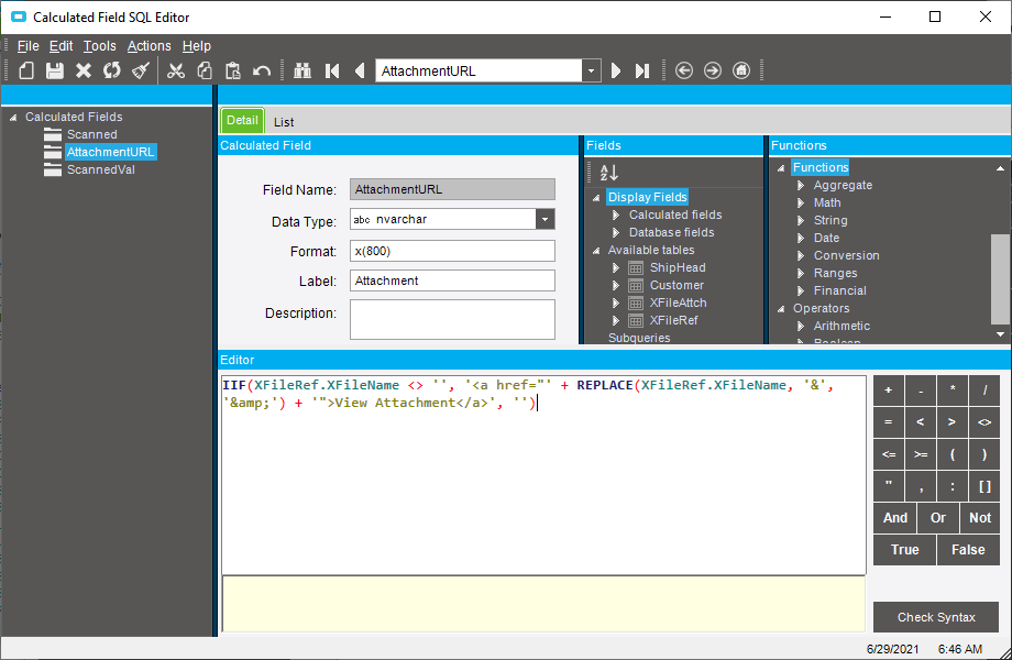

Would anyone know how to have multiple links in one column?
I was able to concatenate multiple attachments into one column, however in the dashboard it appears as one long hyperlink. and I am not sure how to split it into multiple

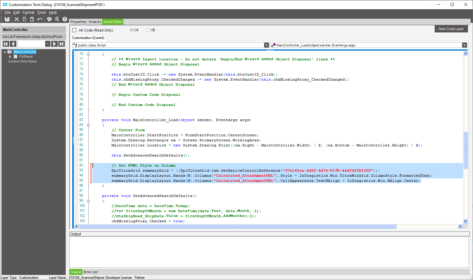

With the following you can use HTML in your cells and have multiple <a> tags.
Note: Infragistics requires & to be &amp; or the column will never convert to HTML. Its a known Infragistics bug that drove me crazy for hours.
_Load Example
// Set HTML Style on Column
EpiUltraGrid summaryGrid = ((EpiUltraGrid)csm.GetNativeControlReference("37e165ce-4d5f-4d76-b13b-46d7d338f3f0"));
summaryGrid.DisplayLayout.Bands[0].Columns["Calculated_AttachmentURL"].Style = Infragistics.Win.UltraWinGrid.ColumnStyle.FormattedText;
summaryGrid.DisplayLayout.Bands[0].Columns["Calculated_AttachmentURL"].CellAppearance.TextHAlign = Infragistics.Win.HAlign.Center;
Thank you… but it appears to only half worked.
I have added both parts (BAQ and dashboard customisation), however in the Dashboard it does appear to be a hyperlink
Any idea?
