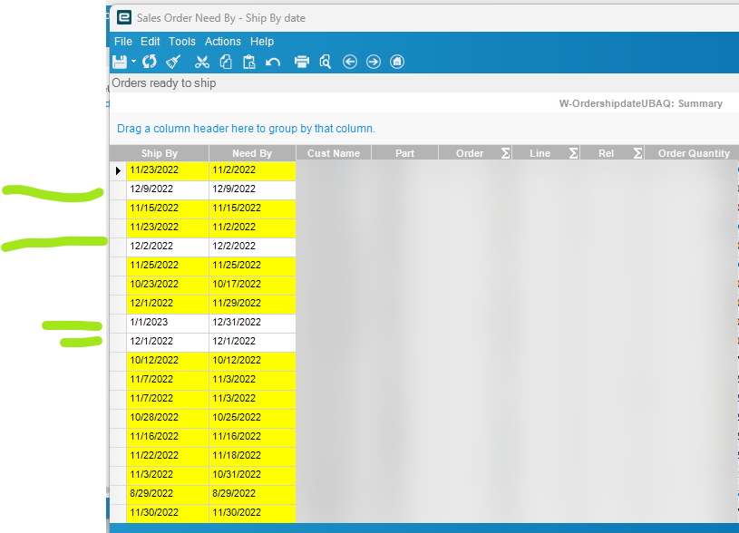

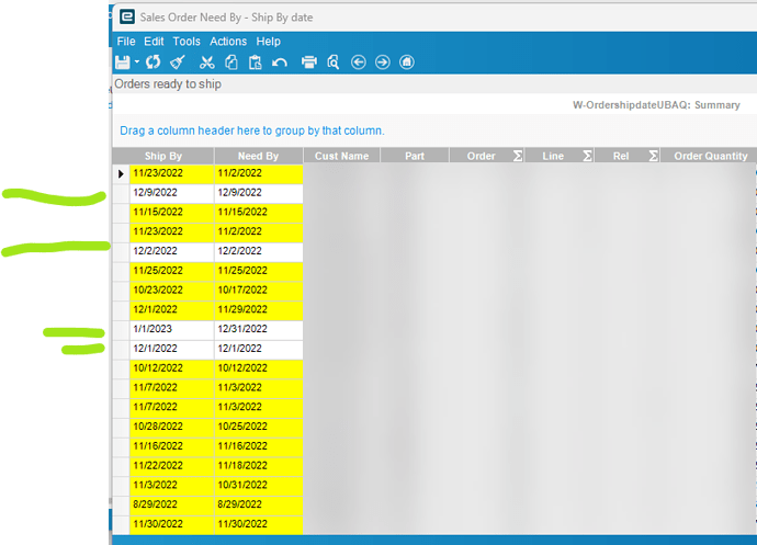

I have a Dashboard with rules to highlight a date field if it equals less than today - Classic view works

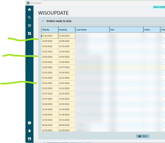

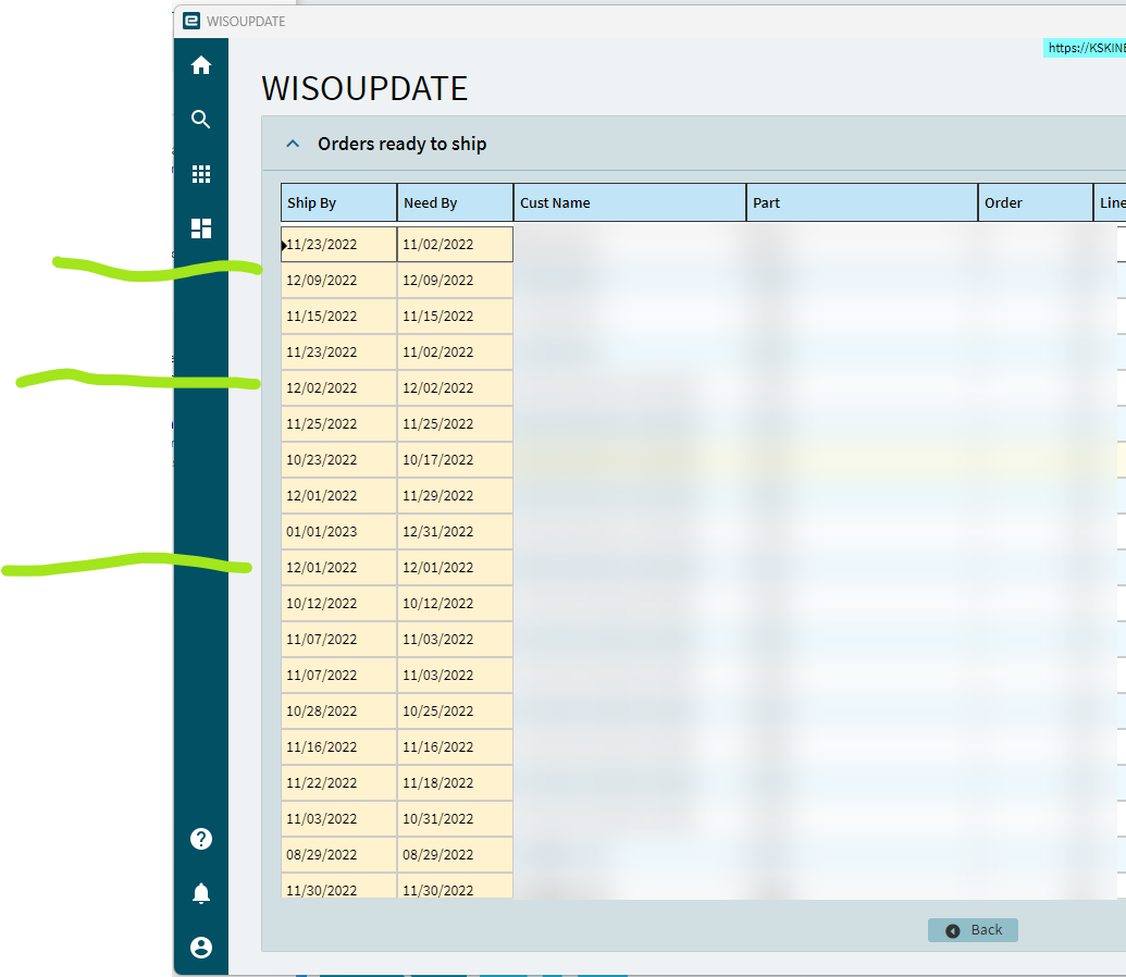

When I publish it as the App - the rule does not apply
What did I miss?
May I see what your rule looks like in App Studio?
Also, as someone from Wisconsin, I can’t help but read your Kinetic’s dashboard title as “Wisconsin Soup Date” lol.
Known issue reported in PRB0254401
PRB0254401 - New UI Kinetic Dashboard – Data Rule with condition of Today not working correctly.
