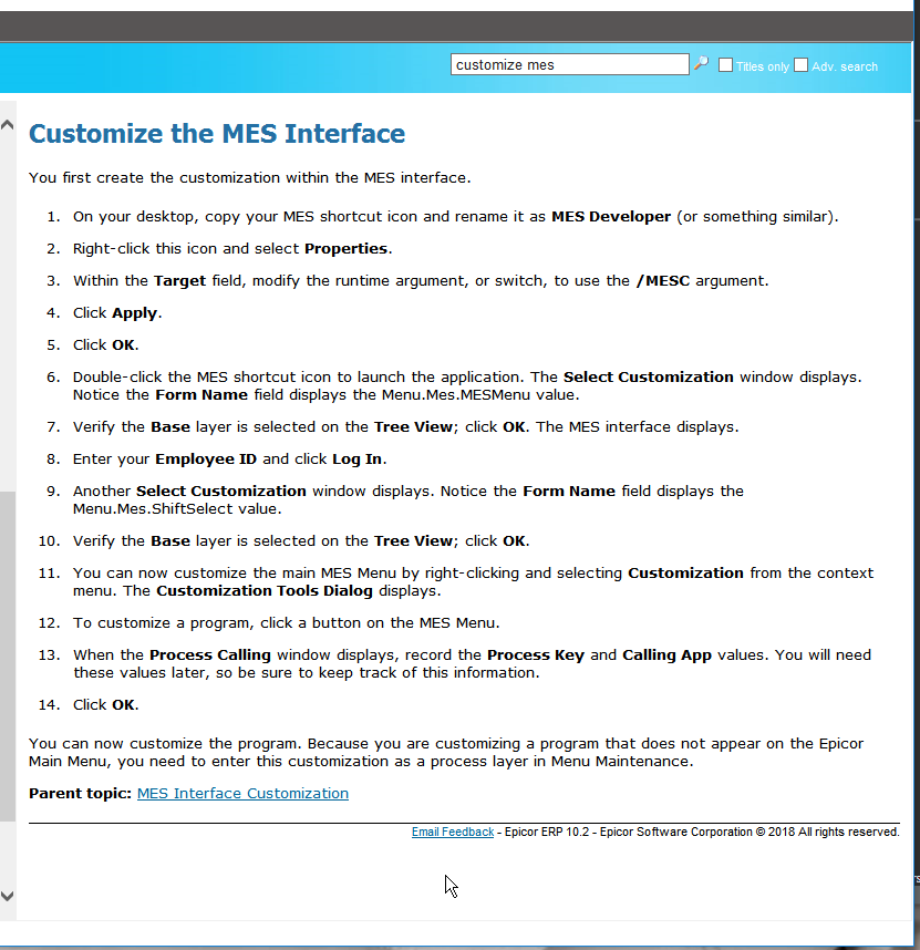

Follow the help file. It walks you through it.
They also have a whole section on MES dashboards
Thank you! This has been a lot of help. One last question. It says to Paste the Code into the Script Editor. This is the part I am a little fuzzy on. Where do I need to paste it? Or do I just paste it over what is already there?
Before I go too much farther (I was side tracked by the customization part I forgot to look at the beginning.), I cannot find the Sub Process the article is talking about. SI this an old article and this is no longer used in E10?

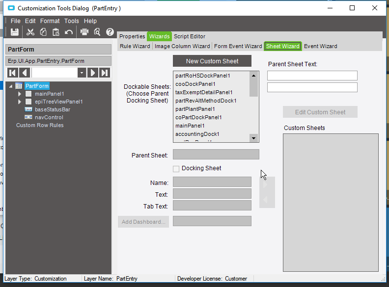

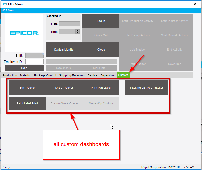

First you need to make the button with the tools. in the help it says “select an open button”, like there would already be one there??? You will have to find a place to put the button. For us, we added a tab (see the sheet editor wizard in customization) for a place to put these buttons since most of the real estate was already taken up. Use the tool box to make a button and set the text and properties.

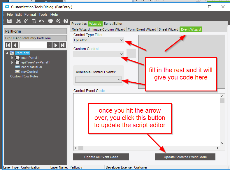

Then you need to use the wizard to make a click event. The click event wizard will make this for you on the script editor. (The help just has you copy it and set the GUID’s, but it’s better/easier to just let the wizard to it for you if you can. And in this case you can.)

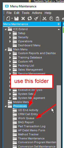

You just need to do that to get a menu ID. If you already have one from the full client, you don’t need to do that. If you don’t have that dashboard in the full client, and you don’t want that menu item, then make a menu item in the Processes folder.

Here is where you set up the event handler for the button you make.
This is the tab where you would make new tabs. (do this first if you’re going to, as it’s really hard to move buttons from tab to tab)

In the Properties of the EpiButton, besides Entering Text, is ther eanythign else that needs to be done? I ask because in the Event Wizard, I selected the EpiButton but no custom controls came up. So something is missing.
You have to save your customization before it will show up. Little quirk.

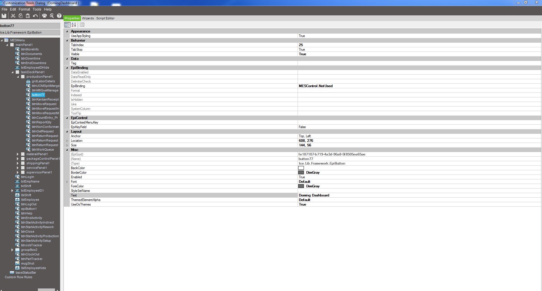

Screen shots please. I would like to see the button properties.
I deleted and started over to see if that helped. Anyway, I still need to enter the Text.
Where did that binding come from? I would remove that.
Just automatically came with it. I will delete and try that.
