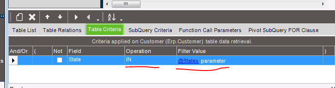

You could use the “IN” operator in the Table Criteria, for the States field
And the @States parameter is type Item List
When the BAQ runs, the user gets prompted to make the list of States to include:
After adding the states (albeit on line at a time), the BAQ returns (my example is just queries the Customer table)
Calvin,
This is a brilliant way to attack the problem. It’s not 100% ideal, but it does solve the issue of a single parameter being able to accept multiple values. One update to what I did though, the field that I need to parameterize is a calculated field, so I setup the above suggested filter on the “Display -> Filter” tab in BAQ Designer instead of as a table criteria. Thank you so much for the input on this!
