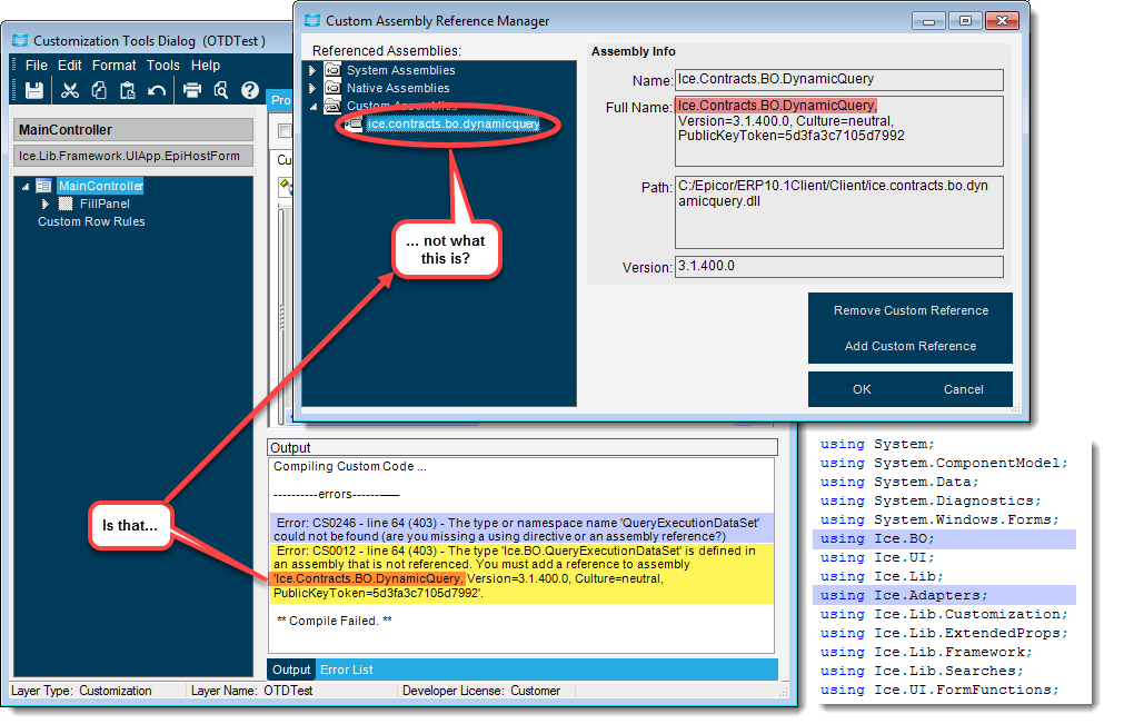

While compiling the code, I am getting an error that is telling me that I am missing a reference to an assembly:
> You must add a reference to assembly "Ice.Contracts.BO.DynamicQuery"
Is that not what I have in my Custom Assembly pool?
Since I have officially been recognized by my wife as being “old”, it is certainly possible that my eyesight and dormant senility are failing me on this particular task.
What are you guys seeing here that I am missing?
(By the way… “Ice.Adapters.DynamicQuery” is already referenced in “System Assemblies”)
use the Import (reference adapter\BL) wizard and find the DynamicQuery adapter (in a funky order on the list).
That should fix you.

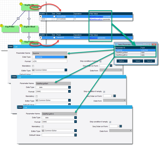

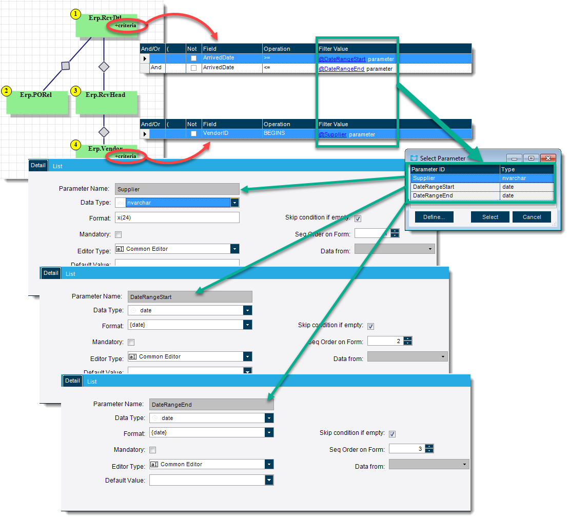

Also, If you could screen shot your params in the BAQ it may be useful.
Also, what happens if you set your params to be SKIP CONDITION ON EMPTY?
Thanks, Chris.
Here is the set-up on the parameters:
The parameters are already configured to skip an empty condition (not mandatory).
Perhaps… should I be using “Guid.Empty()” instead of “Guid.NewGuid()” (but that would go against José’s tutorial)?
