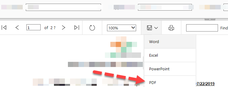

I have a dashboard which utilizes a URL view to open up a specific custom SSRS report.
When I use the control option to save the report to PDF, it launches Internet Explorer :face_vomiting:.
Is there a configuration setting in Epicor to specify how this report is downloaded, specifically from the URL/XSLT View dashboard control?

It’s because it’s hardcoded to use the WebBrowser control to open that report.
You are already in Internet Explorer.
