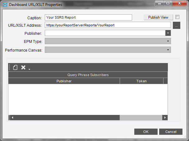

If you have the report hosted on a web site, you can add a URL link to your dashboard via creating a new URL/XSLT view:
Is that what you mean?
It wasn’t but that may be another means to get the job done. What I would like to do is link reports to a dashboard and depending on the dashboard be able to highlight a record and print something like a sales order picklist or a job traveler.
You could look at context field maintenance if you are pulling an existing report, depending on what it is it might work. You could probably to a whole job traveler, but you would have to filter out by assembly sequence if you wanted to go farther than that without customization.
