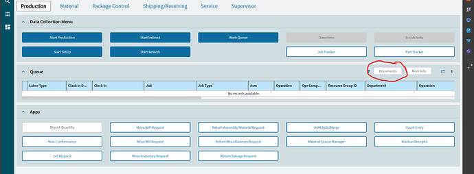

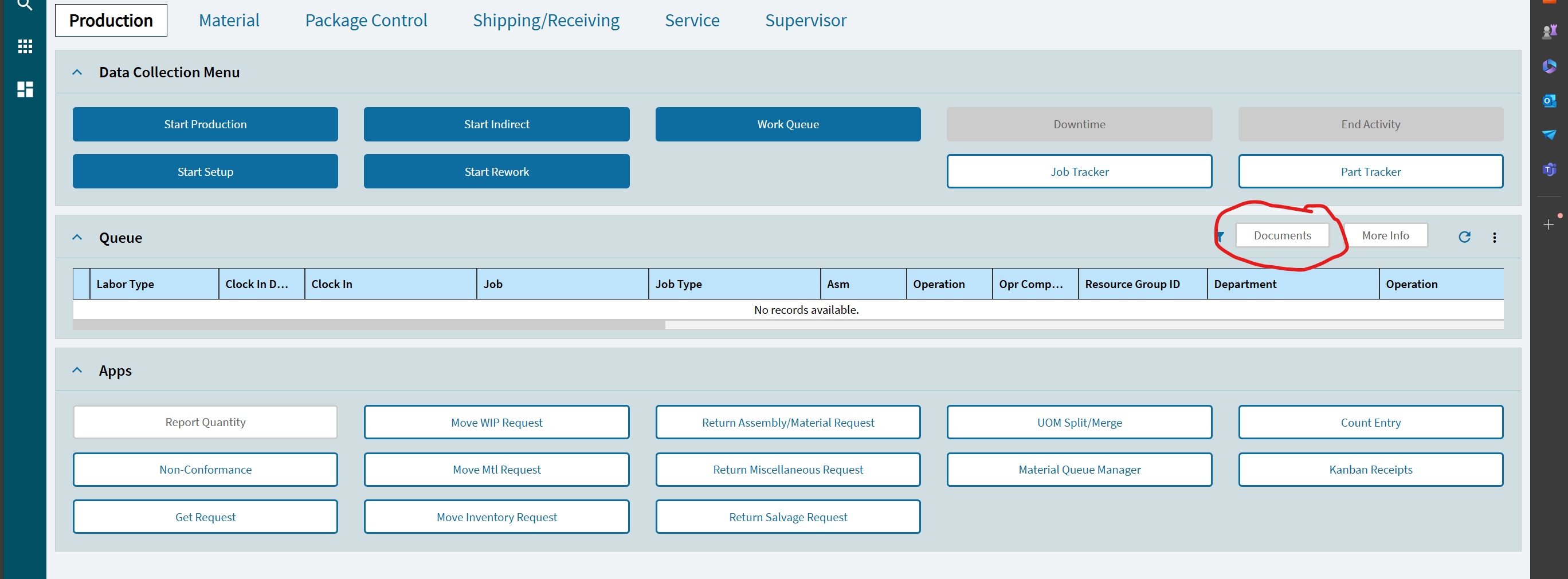

on Data Collection there is this documents button which becomes active when you clock onto a job, however we do not know where the documents pull from.
is anyone utilising this part of data collection, we are hoping it will be a way of going paper free in a simple way

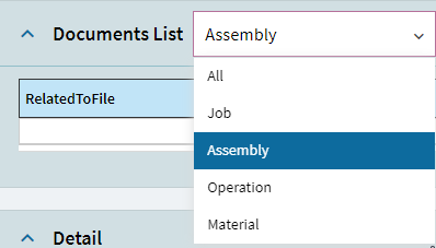

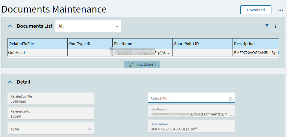

We are using this to store production specifications for the part we are producing. We attach the specs to the part rev which automatically pulls them into the JobHead. Looks like you can also see attachments at the assembly, operation, and material level.
