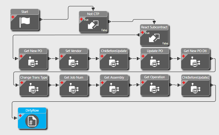

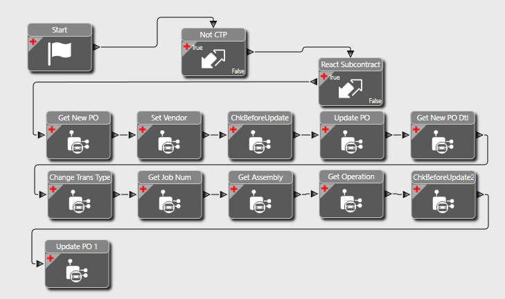

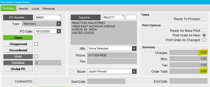

I’ve created a standard DD on the JobOper table. If the new operation is subcontract to a specific vendor it creates a new Purchase Order & Line.
The issue is that it’s not updating some fields like it would if I were to manually enter the PO. Specifically the Summary fields on the Summary tab.

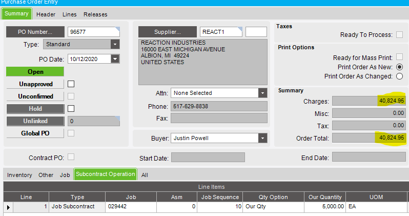

Here’s a manual PO, with updated summary fields:

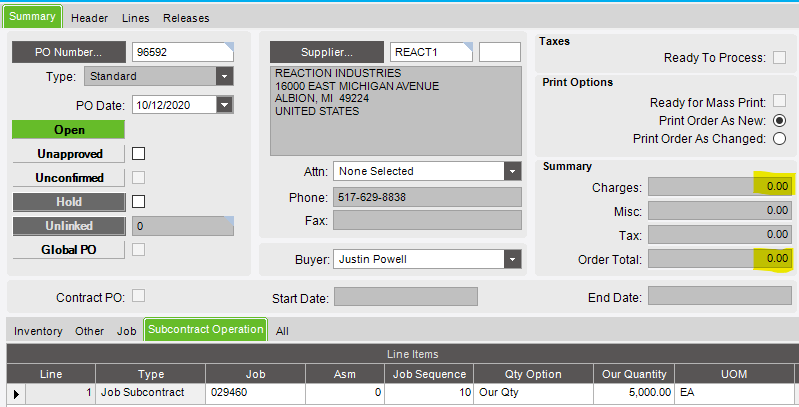

Here’s one created using the Data Directive:
If I go look at the line\release details, they are exactly the same.

I’ve recreated all these steps, following my trace:

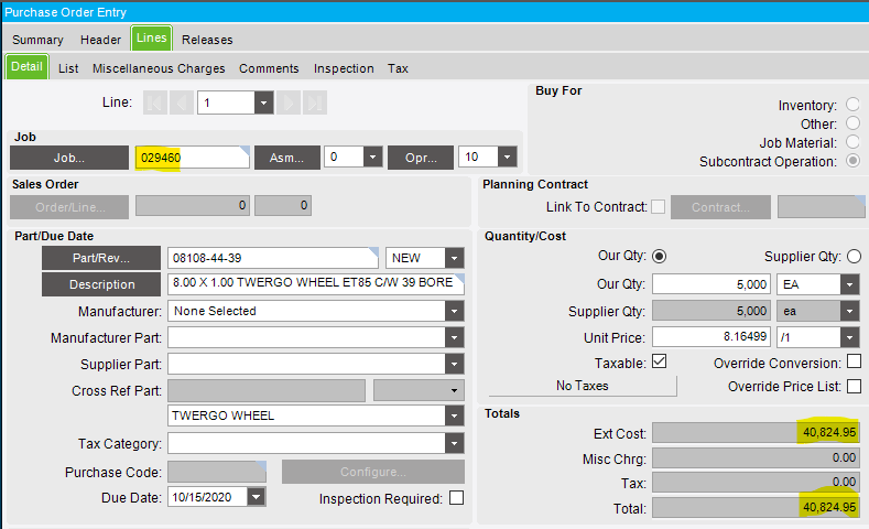

Do you see the lines created and the costs associated with them?
Yes, I believe so. If I open the PO and go to the line detail, it displays the costs:

Before your final update, try to dirty the RowMod (“U”) on the PO header
Like this?
var POApproveSwitchDataSet = POtable;
Erp.Contracts.POSvcContract hPOApproveHandle = null;
if (hPOApproveHandle == null) {
hPOApproveHandle = Ice.Assemblies.ServiceRenderer.GetService<Erp.Contracts.POSvcContract>(Db);
var intPONum = POtable.POHeader.FirstOrDefault().PONum;
if (POApproveSwitchDataSet != null) {
POApproveSwitchDataSet.POHeader[0].RowMod= "U";
hPOApproveHandle.CheckBeforeUpdate(out str2, out str3, out str4, "POHeader", POApproveSwitchDataSet);
hPOApproveHandle.Update(ref POApproveSwitchDataSet);
I tried it, this didn’t work for me but maybe my code is wrong? My programming skill is somewhere between total noob and beginner.

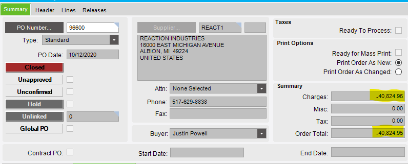

Maybe another hint? I closed the order and it updated the summary to a negative number:
When I reopen the order\line it jumps back to zero:
