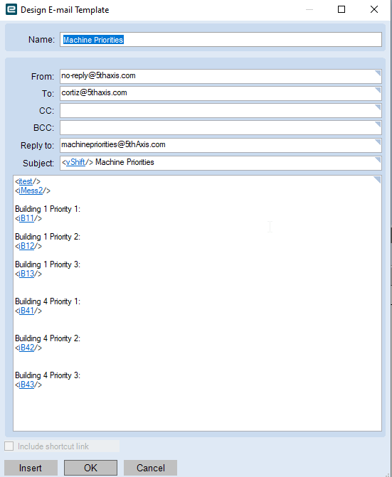

Currently we have this setup in data directives. Here is a portion of the C# code that generates formats the data currently and then we use the Send Email command.
 if (iRecord.SetupComplete == false)
                                    iSetup = "  Needs Setup";
                             else
                                    iSetup = "";
                         iMess = iRecord.Description + "    " + iRecord.JobNum + "    " /*+ iJoinResults.OprSeq.ToString("G") + "    "*/ + iRecord.PartNum  + iSetup;
                         if (iRecord.SchedComment == "1" && iRecord.URL.Length > 0 && iRecord.URL.Substring(0,1 ) == "1")
                    iB11 = iB11 + Environment.NewLine  + iMess;
           if (iRecord.SchedComment == "2" && iRecord.URL.Length > 0 && iRecord.URL.Substring(0, 1) == "1")
                    iB12 = iB12 + Environment.NewLine  + iMess;
Ah, we email out through via a c# code block similar to the examples above. We also have on premise environment which let us install an email server alongside Epicor to handle them. <–(I was not around when the emailer was set up, not sure if you could still C# code and run through Epicor’s built in or not).

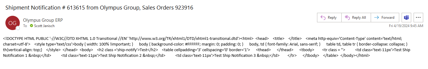

I’m trying to use the email widget in a bpm with html formatting but I just get html like this:
Never been able to get HTML in the email widget to work since it only sends text emails. You can use @klincecum’s function to do it though.

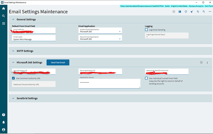

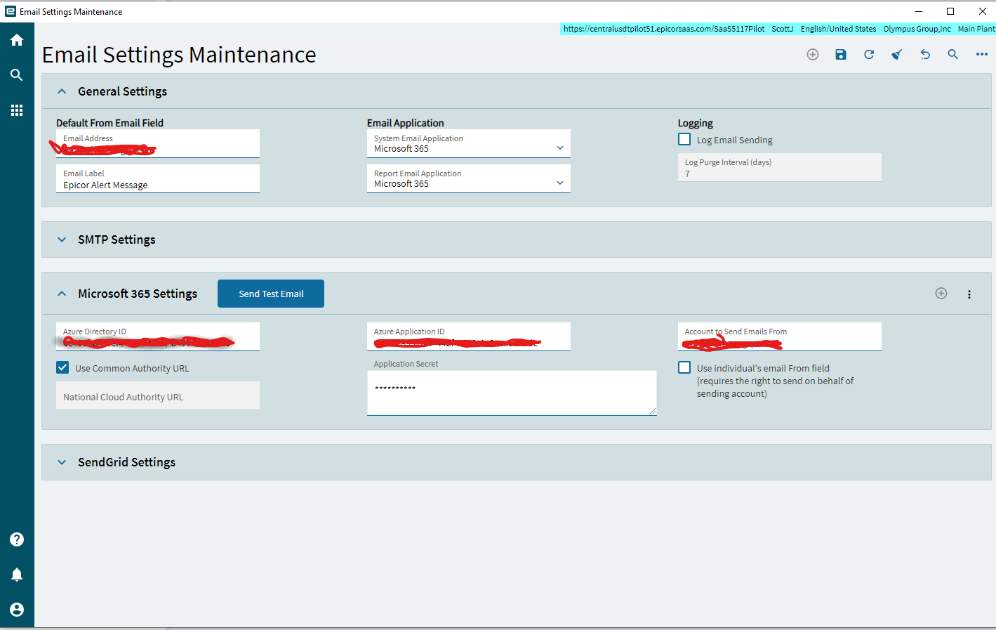

That won’t work for me we are using the (new?) email settings for Microsoft Office 365
Anybody walk me through setting that up so I can test?
My networking guy did that here, I can ask him when he comes in if he has a link to some documentation or something…
Sorry, I forgot to get back to you on this,
In case you haven’t found it, here is a nice Epicor help article:
https://erphelp112400.zendesk.com/hc/en-us/articles/24844163957645-Entering-Mail-Settings#Entering3
(Or search “Office 365” in Epicor help and it’s the first article)
