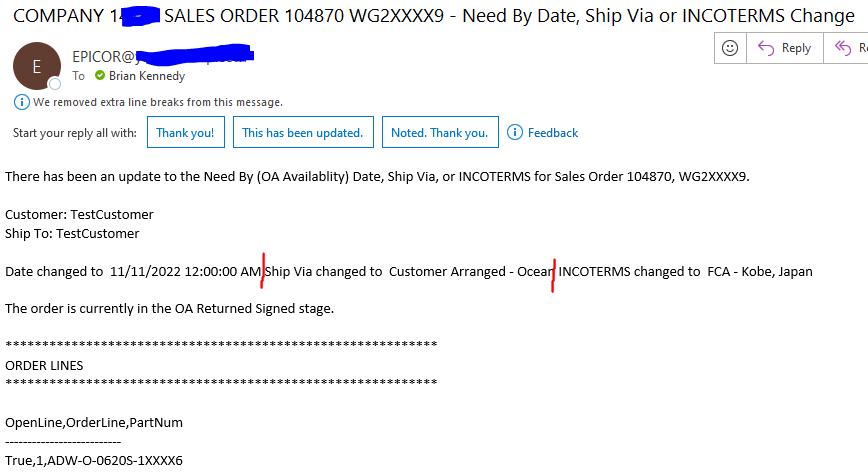

I have a Standard Data Directive on OrderHed.Update that checks if the “Neeed By Date”, ShipVia, or FOB has changed from any to another. It is functional but I have received a request to improve the display format.
I would like to show the previous value and then the new value for each of these 3 fields (if any of them stay the same I would like to suppress that line). I am not sure how to do that email format, so I did a bunch of conditions that drop down to 8 different email formats (so if the data is not changing no line is shown for that field).

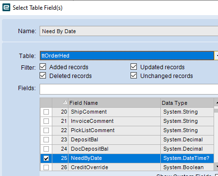

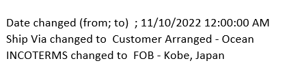

Sometimes (like when there is only a change on the need by date), the “Need By Date” from ttOrderHed shows a before and after separated by a semicolon (but it does this on the company, sales order number, serial number, order stage. I do not know why these fields are printing twice (I did not originally create this BPM).
If I change just the Need By Date, it doubles items.
If I change all 3 items, I lose the line return (showing individual lines for each item) and nothing shows as double:

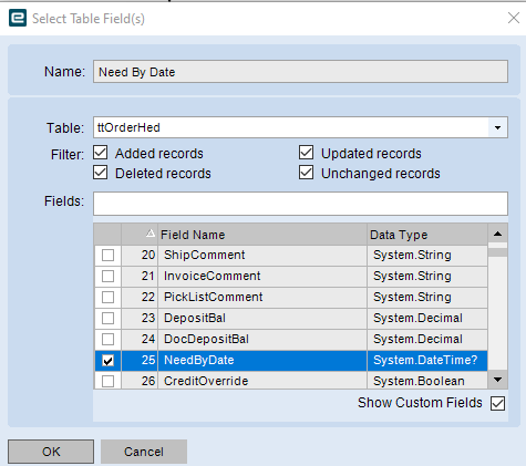

So if I only change the Need by date and have all the boxes checked, then I get before and after on the change.
But if more than 1 field is changed on the same save, then I do not get the before and after.
Does the tt lose the previous value if more than 1 parameter gets updated?
I’ve had numerous instance where the changed value showed up twice. It would be one thing if it was showing the old value and the new, but it is clearly showing the same value twice. Play with the filter checkboxes (Added, Deleted, Updated, Unchanged). Might be some combo of them that works better.

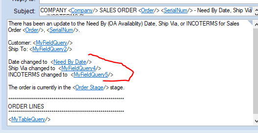

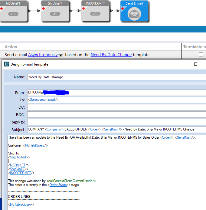

This is what the Email Widget looks like:
This is what the email text looks like:
The < b-r > (without dash) shows up as < b-r > (without dash) and the comma and space+comma shows up as comma and space+comma, but the line return does not show up.
If I try 1 space and Ctrl+Enter, I do not see any line returns in the email, I see this:
If I try 2 spaces and Ctrl+Enter, I do not see any line returns in the email, I see this:
So back to 3 spaces and Ctrl+Enter, the line returns now show up in the email, this:

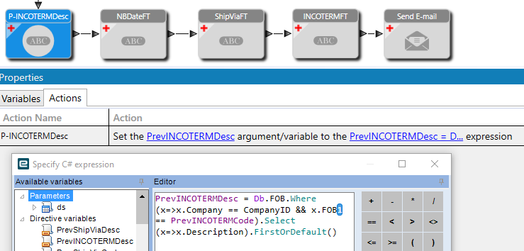

PrevShipViaDesc = Db.ShipVia.Where(x=>x.Company == CompanyID && x.ShipViaCode == PrevShipViaCode).Select(x=>x.Description).FirstOrDefault()

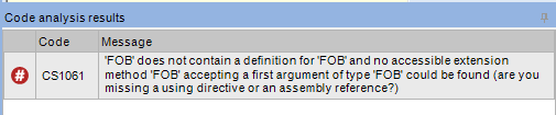

However, when I try the same thing with the FOB database table, I get an error message:
PrevINCOTERMDesc = Db.FOB.Where(x=>x.Company == CompanyID && x.FOB == PrevINCOTERMCode).Select(x=>x.Description).FirstOrDefault()
The Erp.FOB table contains columns called Company, FOB, and Description, so I do not understand the error.
Entity Framework does not allow fields to have the same name as table. In such cases field has suffix1,
So you need to use FOB1 field name in your linq query
Olga,
You are right, FOB1 worked. I changed it to:
PrevINCOTERMDesc = Db.FOB.Where(x=>x.Company == CompanyID && x.FOB1 == PrevINCOTERMCode).Select(x=>x.Description).FirstOrDefault()

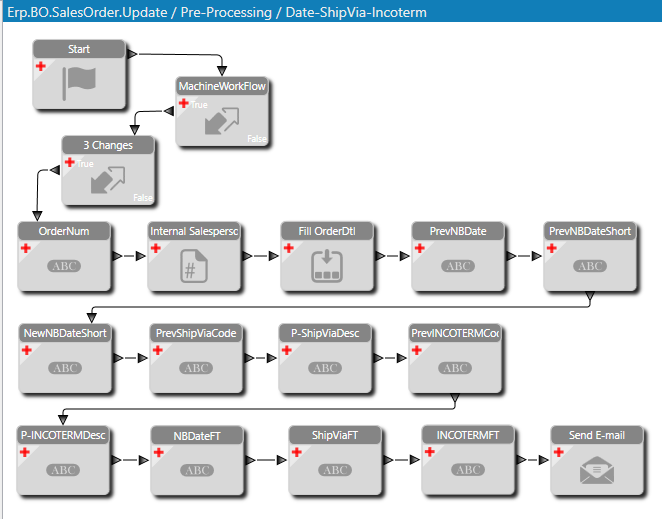

Now it is time for me to share what I did (to help any other users trying to accomplish the same thing). A predecessor created a Standard Data Directive on OrderHed that triggered for a machine order (not a parts order) when the NeedByDate, ShipVia, or FOB changed from any to another. It would send an email that would provide the order number, machine serial number, the current values of the 3 fields that possibly changed, then the open order lines with a part number. It was rather basic and users (especially salespeople who were travelling) wanted more information to help them identify the Customer and what changes occurred.
After unsuccessfully trying to get the “before” value on the Standard Data Definition, I created a Pre-Processing Method Directive on SalesOrder.Update.
So I used 2 conditions. The first one checks some UD fields that identify this is a “Machine” order and not a parts order. The second condition checks that one of the three fields has changed from any to another:
Then I set the order number as a variable:
My predecessor had a custom code widget to get the salespersons email addresses (some minor tweaks were needed to get it to work in a Method directive compared to a Data Directive; like tt becomes ds.) That custom code looks like this:

Then I filled a table by query (to grab the open lines, line number, and Machine part number):
The query looks like this:
With only the 3 display fields I needed:
Then I set the Previous values as variables, beginning with the NeedBy Date:
Then with Calvin’s help (and other tidbits gleaned from EpiUsers threads), Set the date (as another variable) without the time:
Then I set another variable for the New NeedBy Date (short version):
Then I set another variable for the Previous Ship Via Code:
The I set another variable for the Previous Ship Via Description:
Then I set another variable for the Previous INCOTERM (or FOB) Code:
Then, with Olga’s tip (notice the column as FOB1), I added the INCOTERM description:
Then I wanted to add some text that would be conditional (to identify the changed values and also show the unchanged values). I did this with more variables for NeedBy Date, ShipVia, and INCOTERM/FOB. Here is the expression for the NeedBy Date:
The ShipVia (the new values are carried in the ds. table):
The INCOTERM/FOB:

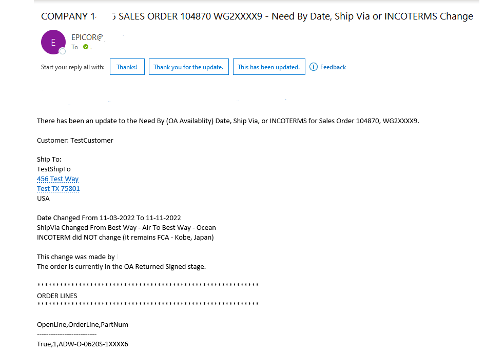

The email then pulls the conditional variable in. The customer name gets pulled through on the ds.OrderHed table as does a formatted version of the ship to address. Then I show my conditional statements to clarify what changed (showing the previous value and the new value) or stating that the field did not change and showing what that value is. I also had to add three spaces then Ctrl+Enter to get my line returns to show properly in the email. I also showed in the message which user made the change to the order, what the order stage is, and then showing the order lines:
Here is what the email looks like:
Hopefully this will help other users.
