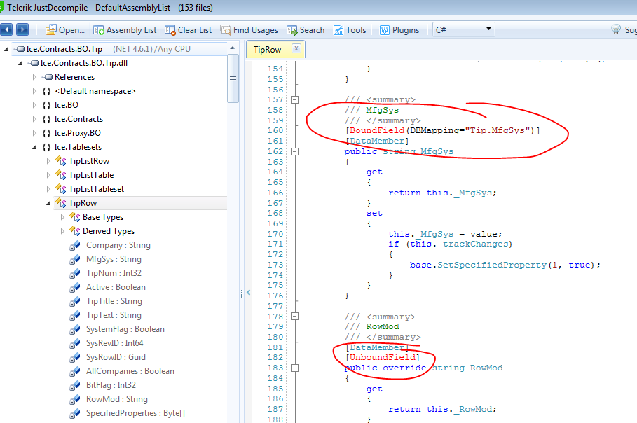

All those are fine. One aspect a lot of folks do not know is that the tablesets in the contract assembly has that technical field help data. Decompile the contract, browse to the tables row definition and note the BoundField and UnboundFields (e.g. unbound = calculated).
Just another way depending on what you have in front of you…
Wow - I learn something new every day. Thanks Bart.

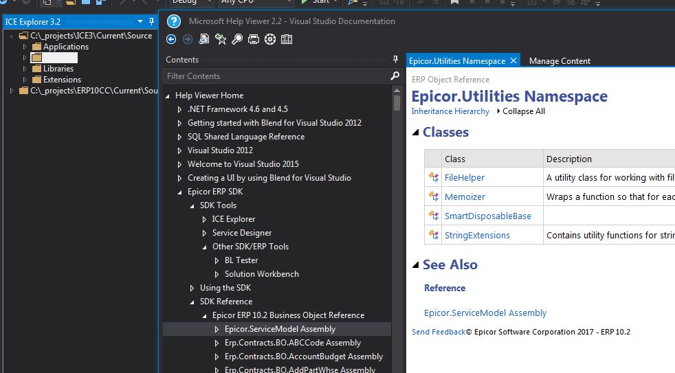

Yup, for in app that is a reasonable source for the data structures. I just go straight to the SDK more often than not as that is the source of information for all the tools that light up information. They have everything data or API.
