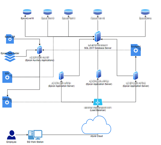

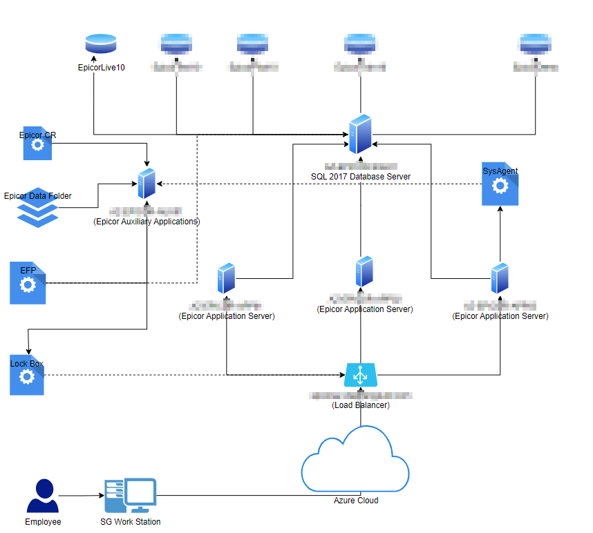

@josecgomez - The more I sit here and think about my options, the more I am leaning towards migrating it all to Azure. You are running a VM with SQL Server installed on it in your Azure Environment, right? You are not simply using Azure SQL?
@Gopher - Are those costs you mentioned based upon experience (IE: that is what you are paying) or speculative (IE: that is what you are expecting to pay when you migrate)? If those are your current costs, can I ask how you have the servers provisioned (specs)? I ask because I am just now starting to price this out and have absolutely no idea what to expect in regards to pricing.
Correct this is what we are running for production
Nice Jose!
Now that is what I am talking about. That is so much better than trying to manage that infrastructure locally between all of our facilities. I am going to be putting together something similar as a proposal to my penny-pinchers…errr…people that control the money, and am hoping that they do not have too much of a sticker shock. I don’t even know what to expect for a ballpark price on something like this. It’ll be fun for everyone! :grin:
