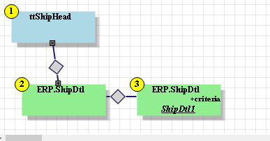

Here’s the Query you need in your condition:
Table Relationship between 1 & 2
Table Relationship between 2 & 3
Table criteria for table 3
That should find rows where SHipDtl’s have the same PackNum (same as the ShipHead), but different OrderNums
