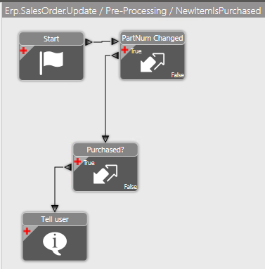

BPM Specification: If a sales order line is entered for a part that is marked as purchased in the part master, throw a message to the screen.

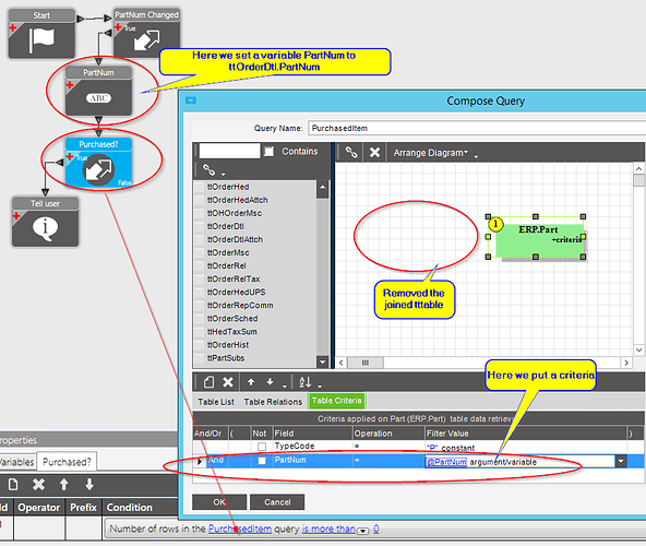

The NEW version (done better) takes only 2 milliseconds:

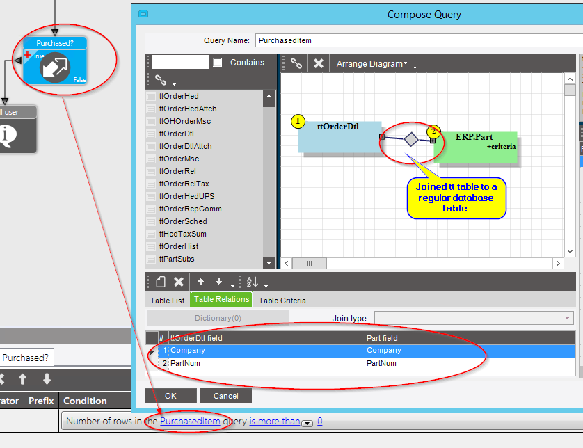

Version 1 (slow) looks like this… the PROBLEM is that it joins ttOrderDtl to Part using a join… THIS IS BAD PRACTICE, and has been discussed in the past on this very forum.
The NEW version eliminates the join… instead, we create a variable to hold the part… populate that variable, and then filter the part using that variable:

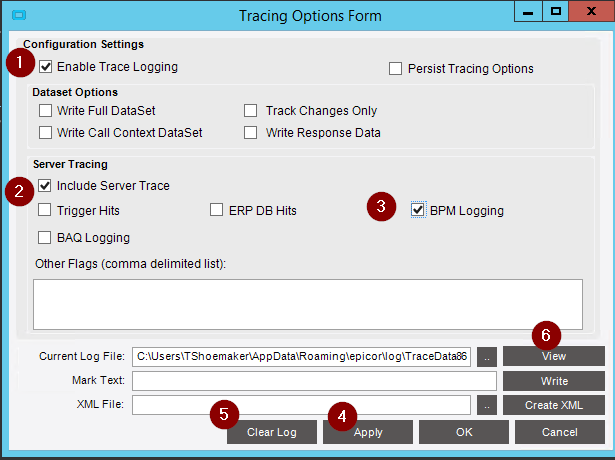

Ashley, it is fairly simple to see the run times…
  1. turn on tracing (bubbles 1-4 in image below)
  2. get ready to do your transaction that will trigger the BPM.
  3. clear the Trace Log (Bubble 5)
  4. do your transaction
  5. view the trace log (bubble 6)
  6. search for your BPM name… also make sure that you search for ALL occurrences of it, as it might be triggered multiple times, but only consume time for some of the triggered events.
    Note that the “Duration” is in milliseconds, so if you see a Duration=“100”, that is equal to 1/10 second. Duration=“1000” - you have now hit the 1 second mark.I found that any BPM that does “something” will take 1-20ms. But, if you have the write conditions setup on the BPM trigger, it will often register 0ms.

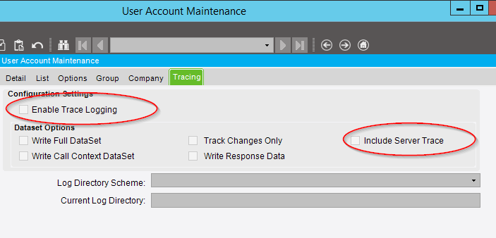

Thank you, Tim. I don’t have the Server Tracing options in the client, presumably because I’m on 10.1? If I check Include Server Trace, and BPM Logging is set on the Application Server Settings in the admin console, will that give me BPM results in my local log?
I’ll give it a shot as soon as I can. I can get it from the server logs if necessary.
Your userID may not have all the features turned on.
Has no effect, except to turn those on by default. I found previous timing of BPMs in the server logs, though. I can still get it.
