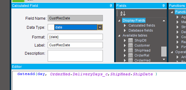

I have a ShipHead.ShipDate which I want to add ship via delivery days to, but within the date add I do not want it to add the weekends of Saturday and Sunday into the calculation as the carriers do not transit over weekends.
My current Dateadd:
Any advice greatly appreciated, ive researched datadd and cannot find any examples where someone is adding one field to another field and excluding weekends …

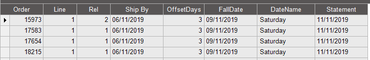

@carlawhite
Date with the additional days added if Shipment falls on weekend =
case
when datepart(weekday,(dateadd(day,OrderHed.DeliveryDays_c,ShipHead.ShipDate))) = 1 then dateadd(day,OrderHed.DeliveryDays_c + 1,ShipHead.ShipDate)
when datepart(weekday,(dateadd(day,OrderHed.DeliveryDays_c,ShipHead.ShipDate))) = 7 then dateadd(day,OrderHed.DeliveryDays_c + 2,ShipHead.ShipDate)
else dateadd(day,OrderHed.DeliveryDays_c,ShipHead.ShipDate)
end
To give you the specific nvar day name:
Date that the delivery falls on =
Format(dateadd(day,OrderHed.DeliveryDays_c,ShipHead.ShipDate), ‘ddddd’)
I was just using OffsetDays as an example
Hope that helps :slight_smile:

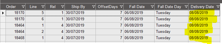

Thanks Alex, is this logic checking if the date it falls on is a weekend? as I need to check if any of the days between the dates are a weekend?
Just tried your code and found where ship date = 30-07-19 with delivery days of 7, I expected a receive date of 8/8/19 but instead it calculates the 06-08-19
