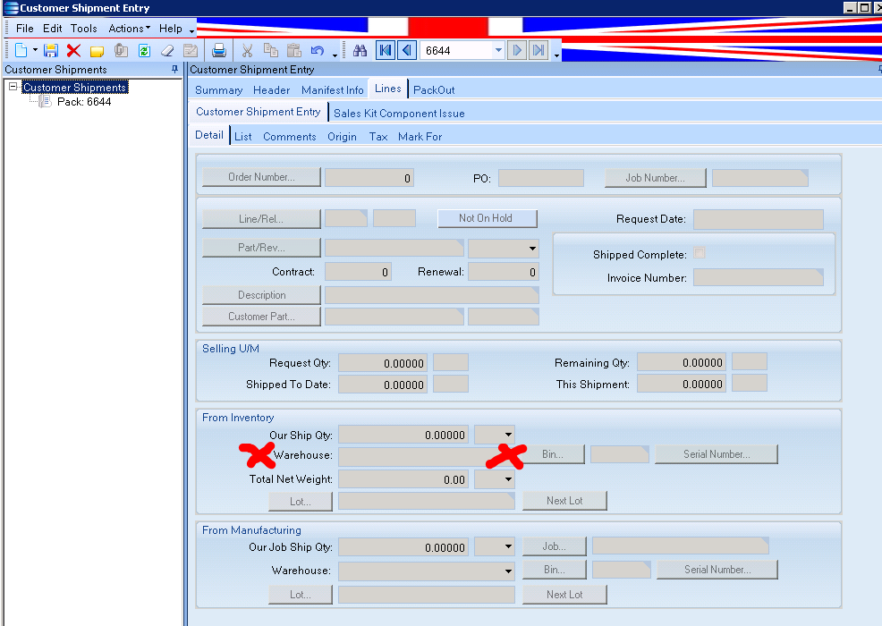

I thought i was getting better at these default fields!..Im having trouble defaulting this field to the Shipping warehouse.
The field is: ShipDtl.WarehouseCode
I believe the bpm method is: CustShip.GetNewShipDtl
Method type: Post processing
From previous tickets I’ve opened, I’ve learnt that you have account for the Code and the description when the field is a dropdown box…so i wrote this ABL code, but it doesn’t seem to work.
For each ttShipDtl where ttShipDtl.Rowmod = ‘A’ no-lock.
If ttShipDtl.PartNum <> “blah” Then Do:
/* Set ShipDtl Warehouse Code Defaults */
Assign ttShipDtl.WarehouseCode = “Shipping”.
Assign ttShipDtl.WarehouseCodeDescription = “Shipping”.
End.
End.
