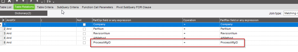

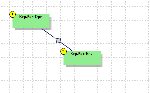

I don’t know what was in the water this weekend at Epicor but this morning everything is falling apart for us.
Drop these two tables in a BAQ

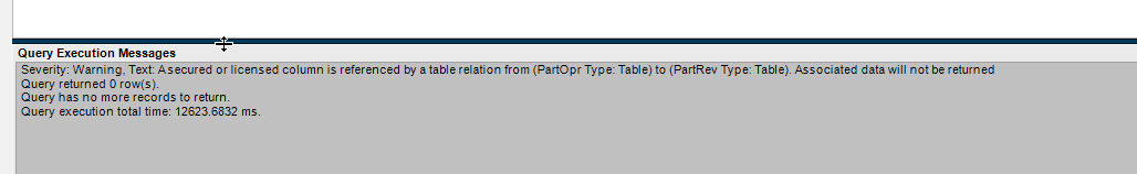

Select Some fields and run it
… just won’t return any results
After 2 hours of decompiling… it appears its stupid ProcessManufacturing link? (Which Epicor does by itself…)
Remove that from the join and all is well.
