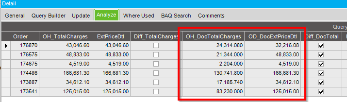

Does anyone know the ins-and-outs of how the OrderHed totals are calculated?
And more importantly, what could cause the OrderHead.DocTotalCharges to be different from the sum of the OrderDtl.DocExtPriceDtl
I’ve got a handful of orders where they don’t match. The difference turns out to be whole lines not being included in the OrderHed Total.
None of the lines are voided, or sales kits components.
On that first row’s order, the OrderHed.DocTotalCharges equals the sum of lines when you exclude lines 2 thru 5. Nothing odd shows for those lines.

If you look at my first screen shot, you’ll see that the Total Charges matches the ExtPriceDtl (which is the sum of the extended prices).

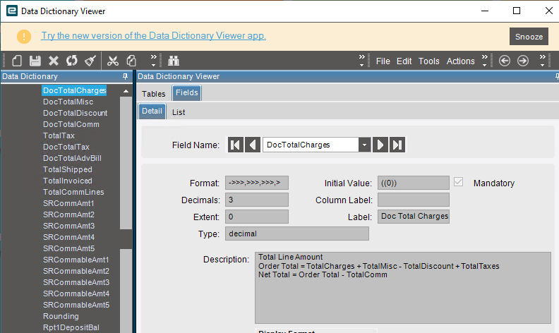

I don’t know, but I just spent a month going back and forth with support over the calculation for the demand quantity in order entry. They finally did get the correct answer from development because what I was seeing didn’t match the field help. But the field help is still wrong.

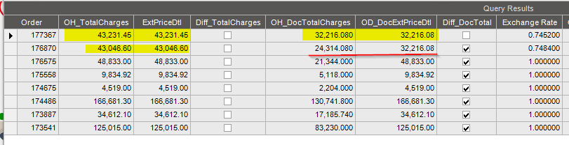

At first I thought the fields I was comparing weren’t correct. But the copy of that errant order comes through as expected (yellows are equal, red is not). There’s a slight difference between the original order and the copy, as the exchange rate was been updated in between them.
