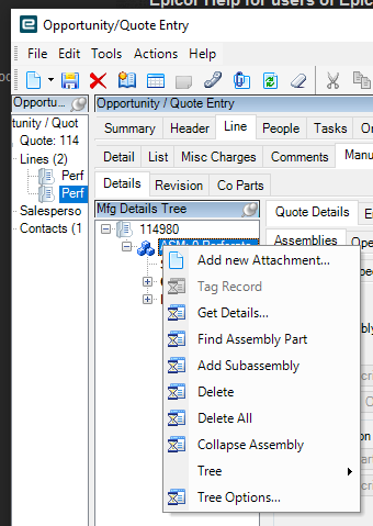

There is already a context menu item to delete the BOM.
If you want a button in addition you would just run a trace log while using that context menu to see what BO methods are being run to delete the BOM. (In this case Erp.BO.QuoteAsmSvc/DeleteAllAssembly)

Thanks! I didn’t notice that before. That worked perfectly. I have to get details everytime to go to worksheet in the quote and look at what the costs are. I have over 200 keep when rules on the BOM of the configurator a drastic change in the bom cost based on the options chosen during the configuration session. I need to use that worksheet to put a mark up on the worksheet to determine a selling price. I truly appreciate your fast response. You saved the day.
