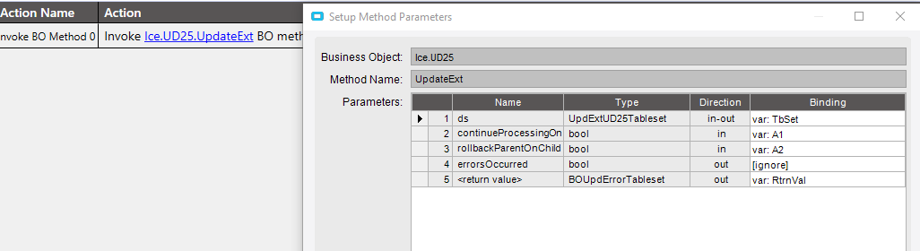

@Will79 You can do this with updateExt like in this thread.

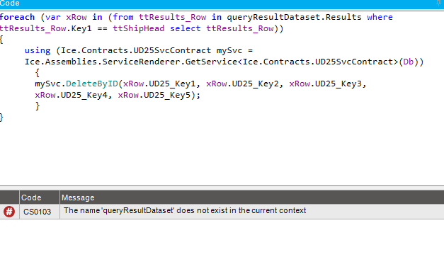

What about something like this?
// step through each row of results
foreach (var xRow in (from ttResults_Row in queryResultDataset.Results where ttResults_Row.Key1 == YourOrderNum select ttResults_Row))
     using (Ice.Contracts.UD09SvcContract mySvc =  Ice.Assemblies.ServiceRenderer.GetService<Ice.Contracts.UD09SvcContract>(Db))
       mySvc.DeleteByID(xRow.UD09_Key1, xRow.UD09_Key2, xRow.UD09_Key3, xRow.UD09_Key4, xRow.UD09_Key5);
This is from a dashboard where I delete UD records that are checked off by the user. It might take a few syntax changes to get it to work in the directive you want.

I’m back to working on this now. What I have done so far is a Method Directive on CustShip Update. I’m not real good at coding, so any help is appreciated.
Condition:
Invoke ICE.UD25
Execute Custom Code:
UD Key fields are:
Key 1: Ordernum
Key 2: Department
Key 3: Pallet Size
Key 4: Empty
Key 5: Empty
Want to delete all rows with the same Ordernum.
Make sure you use a post method - you probably don’t want the records deleted if the order doesn’t save for some reason.
The example below does something similar but with AR invoices and UD11. It deletes all records with Key1 equal to strino. Also, below is just for Key1 as that’s all I needed. You’ll need to extend that to keys 2-5. I used this in a standard data directive and nothing is tested.
