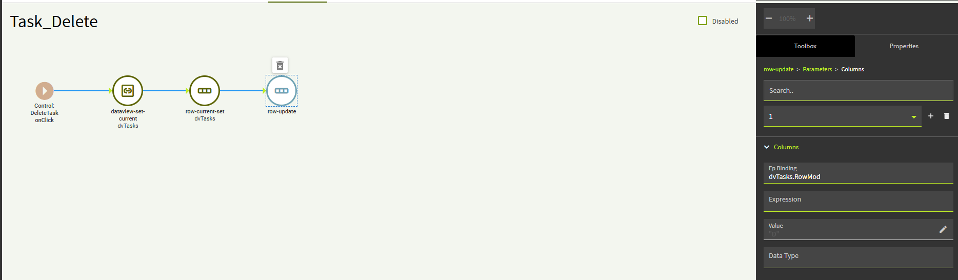

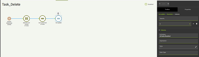

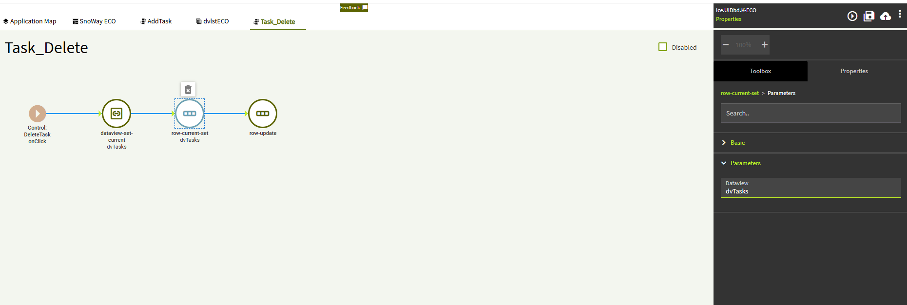

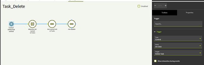

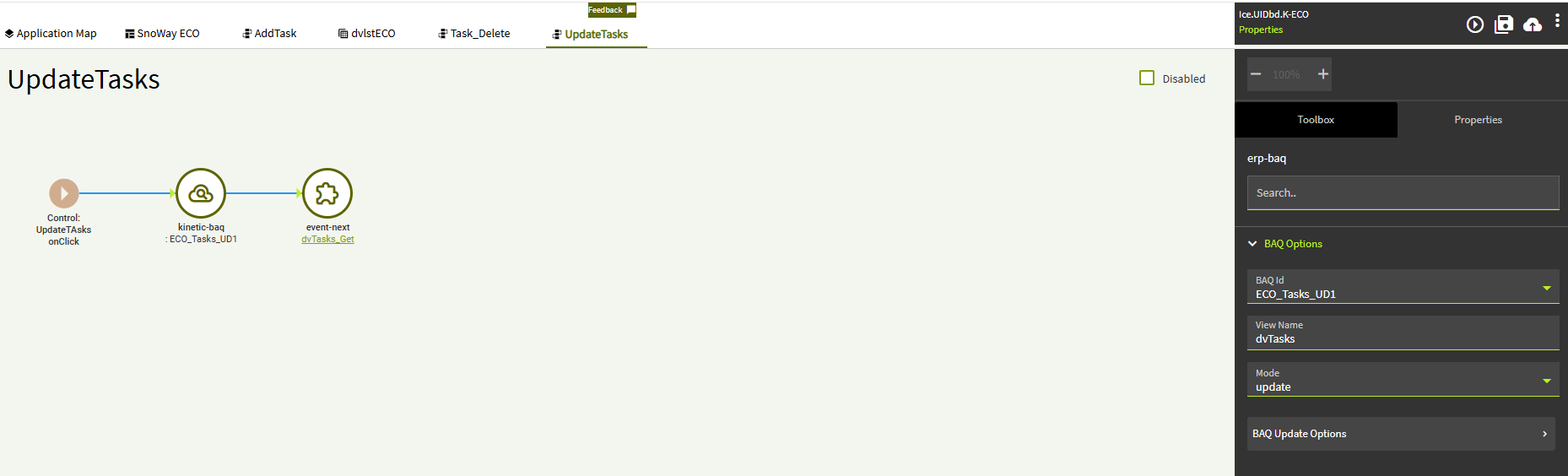

I am using an Updateable BAQ in a part of a larger dashboard. I have figured out how to add and Update records but deleting then is evading me.
This is what I have do far:
Rowmod set to “D”

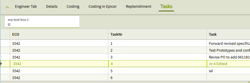

I threw a textbox on a gridpanel to show dvTasks.Rowmod and when I add a record, it shows A , Update a field and it shows U
Going this route MIGHT work… I’ve never tried it. But the row-updates are just going to change your dataset locally. You still need to push it to the server.
So, if you want to try it, I’m assuming you’ll still need a rest call using an update method. The Update may see the rowmod = D value and delete that row during the update. Not sure.
I typically do it with an UD0X.DeleteByID rest call.
I was trying to follow the process I used to add and Update the rows by calling the UD BAQ , setting the mode to Update
Caveat with this is you have to do a on column Changed event for all fields… a bit of a pain but was trying it out to see if it would work. It does not work by setting the RowMod to D

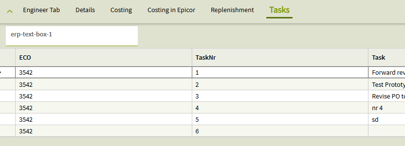

Here is the dashboard before and After updating a row. erp-text-box-1 is bound to dvTasks.RowMod

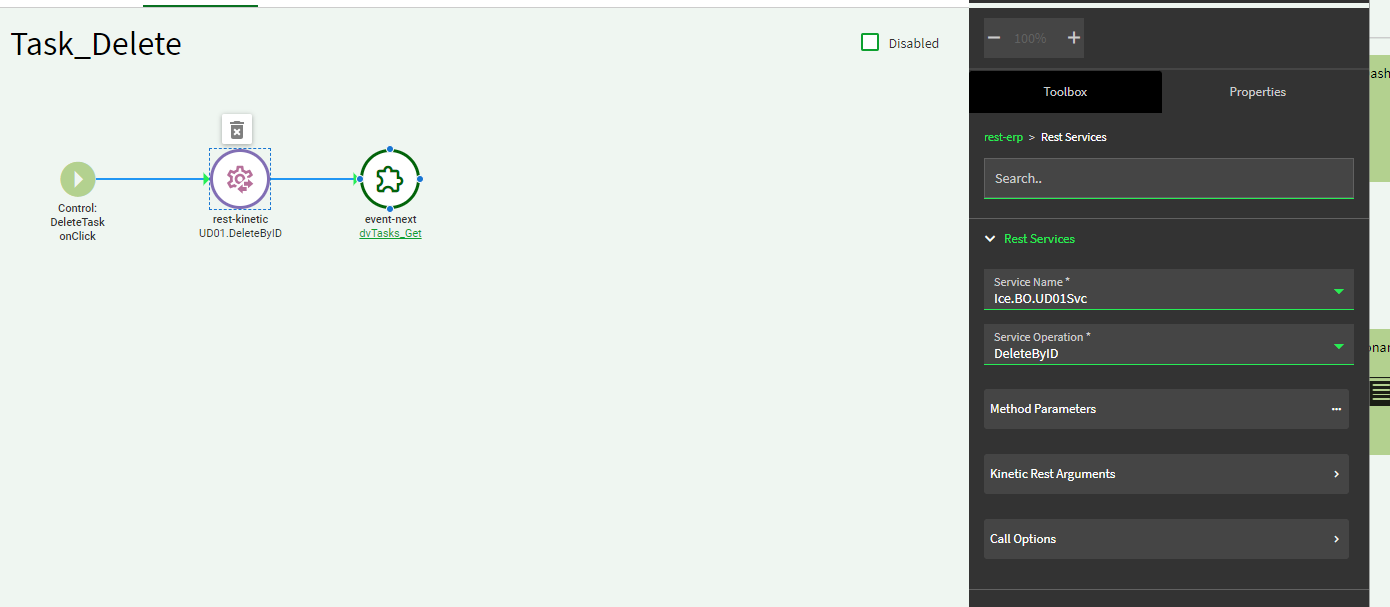

Finally took a stab at DeleteByID . Wow. easy peasy…
Hey, I was wondering exactly what you did to get DeleteByID working as im struggling with a similar problem. would love if you get the chance, thanks.
Working Office Space GIF
Hi James,
Tasks are a UD Table( UD01). I called the rest-kinetic widget using these
Method Parameters are: Key1 through key5( auto magically filled by Epicor)
Hope this helps
This is helpful i have one last question, what exactly is dvTasks in your situation, a BAQ, Dataview, or something else all together?? forgive me if this is a stupid question im rather new to working with epicor
dvTasks is a dataset, filled by an updateable BAQ that contains the UD01 table
