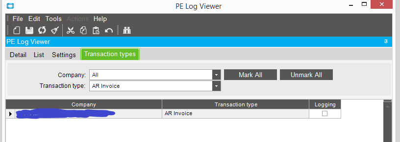

Please run the Edit List and see which account is missing. Another option is to enable PE Log for AR Invoice Type and post the group agian. Then from the PE Log viewer, you should able be identify the issue,
