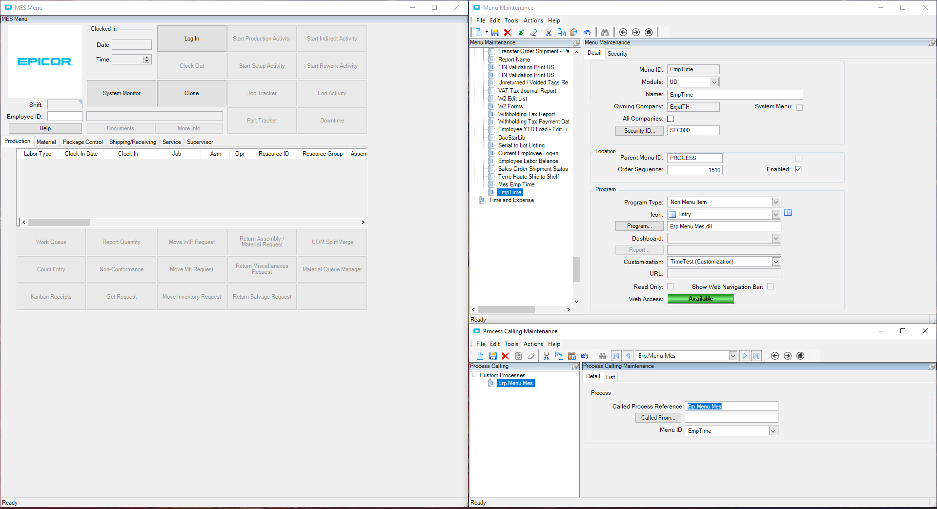

Having an issue now where the customization is not deploying correctly. Below is a screen grab of the menu maintenance set up and the process calling maintenance set up. The mes screen on the left is our live mes. The customization should show on the button in the bottom right of that screen.

Did you move environments or anything? Is the customization available? I know we had an issue where we moved the menu item but the custom didn’t go along for the ride. So it showed the custom was linked to the menu but it wasn’t actually there.
have you added this new MES menu ID to Epicor Config file of your client machine ?

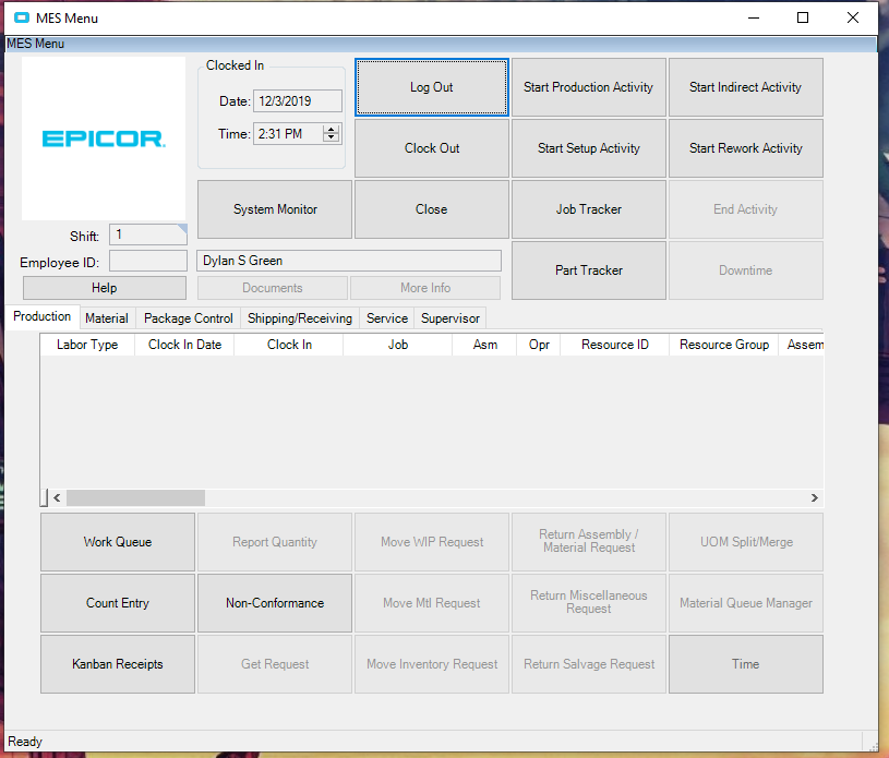

The customization is there. I am testing in both our pilot and live system to try and see whats going on. I was able to get it to show after visiting the Config file on my machine here (Credit to @A.Baeisa). The issue now is that after the sys config is changed the customization I made to the report is not populating correctly. See the pictures below.
The middle picture shows how the customization is supposed to behave when the Time button is pressed. The bottom picture shows how it’s behaving after deployment. It looks like its reverting back to the default version of the report. Any ideas on how to enforce the report customization on it?

is this form one of the defined Process Calling menus ?
